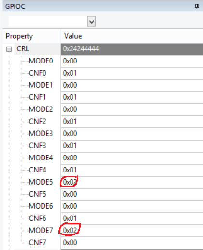

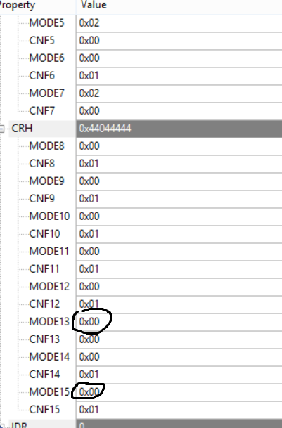

Entered Keil debuger, GPIOC and noticed that MODE13=0, so entered manually value 1 (MODE13=1) and the LED started blinking.
It seems that the LL GPIO driver is somewhat broken because the MODE is wrongly set.
The whole project is attached.

‎2018-01-23 10:27 PM
DAHMEN.IMEN
‌How to reproduce:
If you want to make PC13 and PC15 outputs:
GPIO_InitStruct.Pin = LED_Pin|LL_GPIO_PIN_15;
GPIO_InitStruct.Mode = LL_GPIO_MODE_OUTPUT; GPIO_InitStruct.Speed = LL_GPIO_SPEED_FREQ_LOW; GPIO_InitStruct.OutputType = LL_GPIO_OUTPUT_PUSHPULL; LL_GPIO_Init(GPIOC, &GPIO_InitStruct);You can see that CRL is configured by the LL:
instead of CRH:
so when you try to fix it you use:
GPIOC->CRH = 0x24244444;
Can you consider it a bug?

This issue is not about LED blinking - it's about wrong pin setup...
‎2018-02-01 7:25 AM
Checked the schematic:
I=(3.3V-1.6V)/510ohm ~ 3.3mA so I am sure it won't break the MCU.
Anyway, I was complaining about wrong port setup (I guess for pins 8-15) of the port GPIOC. But i believe it also applies to other GPIOX.
Instead of setting up pins 8-15, the pins 0-7 are configured.

‎2018-02-01 11:22 PM
HAL works fine - output is alive
LL is affected and requires a fix - in this case (PC13): GPIOC->CRH = 0x24244444;
That's why I think it's a bug AND lack of consistency (HAL vs LL).
