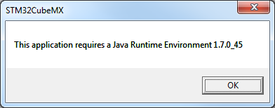

Well, when I went to test the one I have here at work, I found another issue: I have Java u55 installed, but Cube keeps giving me this error when I try to boot it up now:
PS: It had been working until I closed out of the *.ioc file earlier today.

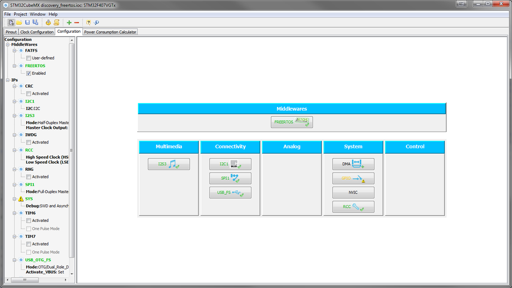

Attached is the file I know is not working. This is the problem at least I experience:
Notice the lack of any formatting of the NVIC button? This should be formatted like the I2C or at least the DMA button. However, it's not. Clicking on it results in absolutely nothing happening, as well. You can no longer gain access to the NVIC settings.

stm32cube-t
Posted on May 26, 2014 at 13:51
Bug is confirmed. Thank you for reporting this issue. We'll try to fix it for the next official release.
