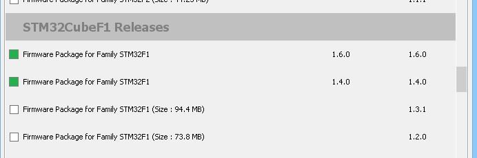

Hey guys,
is there any way to remove old Firmware packets, which have been imported via a local stm32mcube source in cubemx.
If not how can I be sure that when I start a new Project cube mx uses the latest libraries?
thx for your Support.

You can delete old package from your firmware location or remove it from CubeMX : Help >> New Libraries Manager, pick the package then click on 'Remove Now'.
You can check used firmware package version in the 'Project Settings'
For more details please refer to the STM32CubeMX
in the '3.5.4 Removing libraries' section.Best Regards
Imen

‎2017-10-17 7:37 AM
Hey
thx for your replay.Unfortunately the Remove Now Button is greyed out but the library is still marked with green.However when I go to project Settings V1.6. is selected. So this answers my last question

You must select the package you want to delete first. Or you can delete the files and folders directly with Windows Explorer.
‎2017-10-17 11:37 PM
hey,
i tryied to select the package (i.e. left click on the old Firmware package) but the button is still greyed out.
Where can i find the files in the Explorer?
