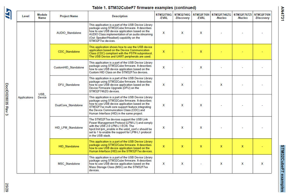

Mon2
Senior III
Posted on December 14, 2016 at 11:41
Oh oh.
According to AN4731 STM32CubeF7 examples document - the CDC examples are not compatible with the STM32F7 DISCO boards. See Table 1. On this note, the HID examples ARE compatible with the STM32F7 DISCO boards.
Your pending STM32F7 Nucleo boards are also not marked as compatible with the CubeMx generated code for USB CDC but HID examples will work.
