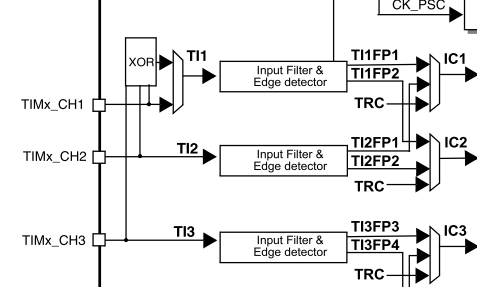

Bonyour,
I am refering to the STM32F2xx Ref manual, Timer, XOR function (also known as Hall Sensor Interface) asto above picture-extract on page
I try to understand.
We have the 3 Timer inputs CH1,2 and 3 each going to its dedicated input-signal-conditioner.
On CH1 there is an XOR Gate whos inputs connect to CH1,2 and 3.
(Is that a real XOR-Gate or just an OR-Gate??)
Its output goes to an ??-Gate that also accepts the original CH1 signal.
What Logic Gate would that be?...OR-gate?
As i understand, the TI1S-bit would switch the XOR-Gates output to the ??-Gate input.
My desired APP was to use CH1 as a clock input.
CH2 and CH3 receive a Gate-signal that shall inhibit the CH1 clock when they are high.
(XOR function)
But it does not seems to work.
Has anybody experience with this XOR functionallity?

    Its output goes to an ??-Gate that also accepts the original CH1 signal. What Logic Gate would that be?...OR-gate?
    MUX one of the inputs is feed to the output based on some register selection (TI1S bit in the TIM_CR2 register)
