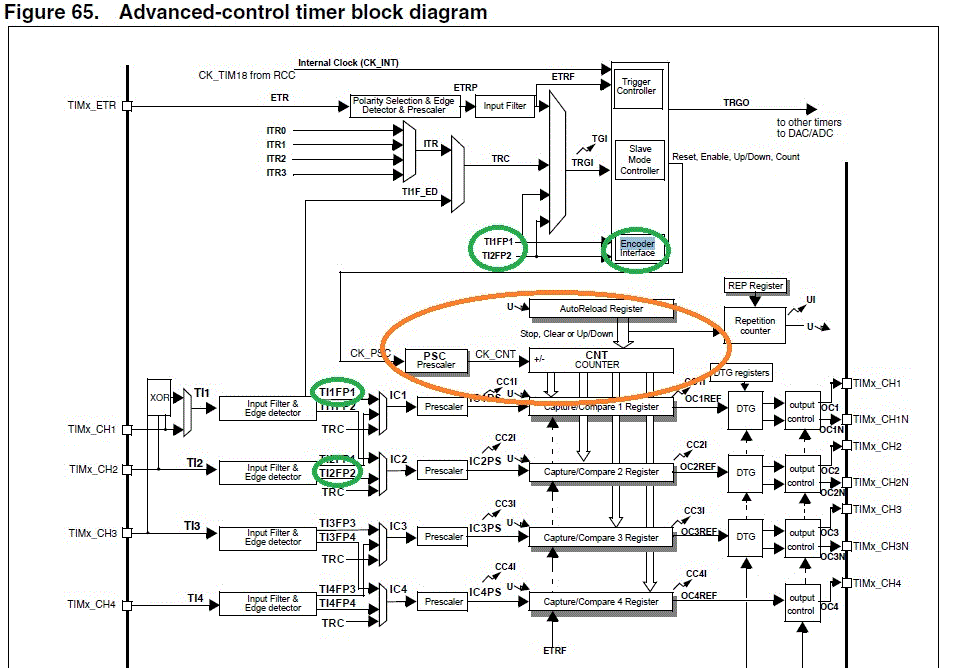

I am trying to use timer 8 in Encoder mode and my setup is as follows. Pins PC8 and PC9 (timer8) are connected to a cheap 3 terminal encoder that has C pin grounded so pullups are activated on these pins.
TIM_TimeBaseInitTypeDef TIM_TimeBaseStructure; GPIO_InitTypeDef GPIO_InitStructure; RCC_AHB1PeriphClockCmd(RCC_AHB1Periph_GPIOC, ENABLE); GPIO_InitStructure.GPIO_Pin = GPIO_Pin_8 | GPIO_Pin_9; GPIO_InitStructure.GPIO_Mode = GPIO_Mode_IN; GPIO_InitStructure.GPIO_OType = GPIO_OType_PP; GPIO_InitStructure.GPIO_Speed = GPIO_Speed_100MHz; GPIO_InitStructure.GPIO_PuPd = GPIO_PuPd_UP; GPIO_Init(GPIOC, &GPIO_InitStructure); RCC_APB2PeriphClockCmd(RCC_APB2Periph_TIM8, ENABLE); TIM_TimeBaseStructure.TIM_Period = 0x0FFF; TIM_TimeBaseStructure.TIM_Prescaler = 0; TIM_TimeBaseStructure.TIM_ClockDivision = 0; TIM_TimeBaseStructure.TIM_CounterMode = TIM_CounterMode_Up; TIM_EncoderInterfaceConfig(TIM8,TIM_EncoderMode_TI1,TIM_ICPolarity_Falling, TIM_ICPolarity_Falling); TIM_TimeBaseInit(TIM8, &TIM_TimeBaseStructure); TIM_Cmd(TIM8, ENABLE);
I then read the counter with temp=TIM_GetCounter(TIM8);
I have tried all the possible modes and falling/rising combos I can and am getting nothing. Does the Timer channel have any effect. It is using channels 3 and 4
I assume that there doesn't need to be any interrupts setup but maybe this is incorrect.
Any suggestions would be appreciated. Thanks

    On what part exactly? ST makes dozens of STM32xxx parts. Some will require AF pin routing to be specified.
    How does CH3/4 route to TI1FP1 or TI2FP2, refer to ''timer block diagram''

    Posted on August 22, 2012 at 20:29
    Ok maybe that's the issue. I am using STM32F407VGT6 part and it looks like PC8 and PC9s alternative function is TIMer channels 3 and 4 so it won't connect to channels 1 and 2 that are needed for the encoder interface. I wish I had looked at that diagram more closely when laying out my board. I am assuming I can't use the AF function to connect to another channel if it is not available in the AF list for that pin. (I don't have a complete grasp on the AF feature yet.) Is it true that one needs to define AF functions for any pin that is being used other than as a simple GPIO? For example if using SPI I need to set up port using AF assignments?

    Posted on August 22, 2012 at 20:58
    For non-GPIO function the pin drivers need to be connected to the appropriate peripheral using the AF pin multiplexor.
    This isn't a cross-bar switch, so the specific pins, function and peripheral selection is limited. Refer to the ''Alternate Function Mapping'' table in the part datasheet. Pg 58
    http://www.st.com/internet/mcu/product/252jsp
    http://www.st.com/internet/com/TECHNICAL_RESOURCES/TECHNICAL_LITERATURE/DATASHEET/DM00037pdf

    Posted on August 23, 2012 at 21:00
    Thanks for the tip Clive. I had mistakenly assumed that peripherals could be remapped. Always something new to learn. BTW where did you find that diagram for timers you posted? I can't see it in the RM0090 reference.

    Posted on August 23, 2012 at 21:48
    I pulled it out of RM0033, for the STM32F2 as most STM32Fx parts share a similar construction, and I had it open already.
