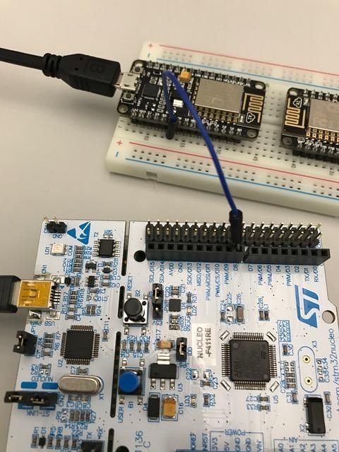

Hello!
I am encountering problem that the USB battery cannot power up the STM32 Nucleo F411RE
after I enabled the UART communication with ESP8266 Nodemcu.
I can have the PC USB working ok and see the UART communication from the COM port on PC.
However, after I replace the PC USB with the USB battery on either the STM32 Nucleo F411RE or the ESP8266 Nodemcu, I would not see any UART communication at all via the COM port.
My USB battery is already with output 5V 1000mA and it is able to drive either the Nucleo board or the ESP8266 Nodemcu before I used the UART communication between them and so I can tell that it's somehow related the UART communication enabled. But I can't understand why UART would make such a difference?! My UART setup is primitive and so no sleep mode is used yet.
I even tried directly with USB Wall Charger but I still could not see any UART communication from the COM port then.
Therefore, I doubt if it would help even if I buy new 2000mA USB battery?!

Yep, my bad, I didn't read carefully enough your message. Can you post the schematic of the connections between the Nucleo and the NodeMCU ? Do they share a common ground ?

No Problem. Thanks. Here it is. I don't have any common ground and you can see that I can plug in the USB battery separately through the mini-USB to the Nucleo board or micro-USB to the ESP8266 Nodemcu. I need one TX output from D8 of Nucleo to send the data to the RX02 (D7) of the ESP8266 Nodemcu. And I can add another wire to connect the GND to become common GND?!
2017-03-01 11:59 PM
Ok so now it makes more sense. You cannot omit to link the 2 grounds together, as it acts as a reference for the Tx signal for both boards. When you used the PC as power source for both boards, their grounds was more or less the same (depending on the current consumption and the USB cable resistance which is negligible here). Therefore the Tx signal was correctly referenced for both.
Now, I'm quite confident that if you add a wire to link the 2 grounds together so that they are the same it will work.

Thanks a lot, Kraal!
It works after I connect the GND together and I can even use one USB battery to drive both now
as I use pin 12 of CN7 to give the 3.3V to the Wifi module.
