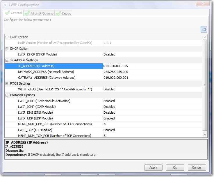

Yes. Use STM32Cube MX LwIP configuration window to specify the IP address (Disable DHCP to see the IP address field) and see the specified IP address in the generated file called ''lwip.c''.

This is what I see on lwip.c.....I recompile it, but still can not get a proper IP address,
I use DP83848 as a PHY chip.... Any ideas to make it right ?

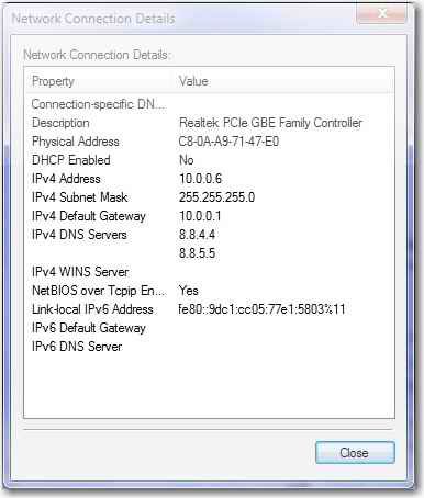

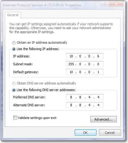

You need to make sure your computer and your board are on the same network (same address range) or you will need a routing table to route packets from one to the other.
You have configured your board IP address to be 10.0.0.5.
Configure your PC address to be 10.0.0.6 for example, and reuse the same gateway IP address 10.0.0.1.

So I must set my LAN network as static IP with 10.0.0.6 ? thanks

I have set it, but still can not ping to my STM32 board....I'm using RMII setting for ethernet...and DP83848 chip for PHY....do I need a clock from STM32 or can I use a clock from the module itself ? it has a crystal but there's a port for OSCIN..??

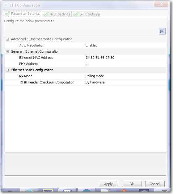

Is it possible for me using it on STM32F407 and 107 ?
I have 429 but the ethernet board is connected to 107 ..
Please find my 107 project STM32F107 attached,
and the ethernet board has 50Mhz clock, and RMII mode...
How do you reckon ? }
Here're the setting on STM32CubeMX for MAC and IP address, I think there's something wrong with it...?? I follow all the procedure and hardware connection carefully and still can't get, at least MAC address... 0690X00000602xtQAA.jpg 0690X000006033qQAA.jpg It works already, but I'm not using STM32CubeMX generated code, I'm not sure, the code generated from STM32CubeMX is reliable for STM32F..
