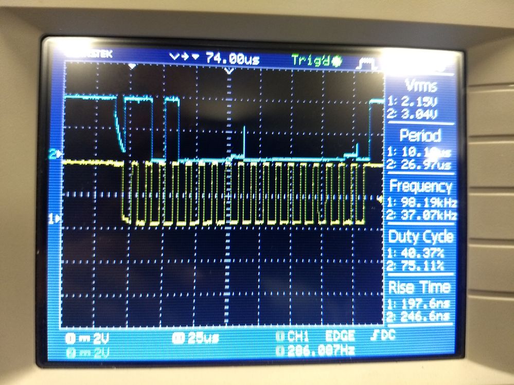

I have already used I2C1 successfully on STM32F051. However, when I am trying to use the I2C2 on STM32F051R8T6, the problem is that the voltage level of the data received on SDA line seems to be chopped. Am I doing anything wrong with the initialization section for I2C2 in particular? How about the clock source, I have not specifically mentioned any clock source for I2C using RCC_I2CCLKConfig() function, since I have read that I2C uses PCLK as its clock source unlike I2C1.
Kindly help me in resolving this issue.
Note: I have used 4.7K as pullup as device(BQ32000) datasheet suggest.

From the above image you can see that the pulses seems to be chopped.
The first set on SDA defines the slave read address, 11010001, the last bit 1 is not proper. What could be the reason?

GPIO.GPIO_OType = GPIO_OType_PP;
I2C expects Open-Drain, not Push-Pull
GenuineDeveloper
Yes, agreed. I tried both to check, OD as well as PP, but there was no change in the output(the code had the later PP config that I had tried).
Pins used for I2C don't need the internal pullups/pulldowns enabled. Those little spikes you're seeing are when the SDA is released following the ACK clock interval. They don't normally indicate a problem.
What's shown on the scope trace is an I2C write (SDA at the rising edge of the 8th SCL is a 0). This is from line 40 in your code.
I'd suggest you fix the comments to match the code.
