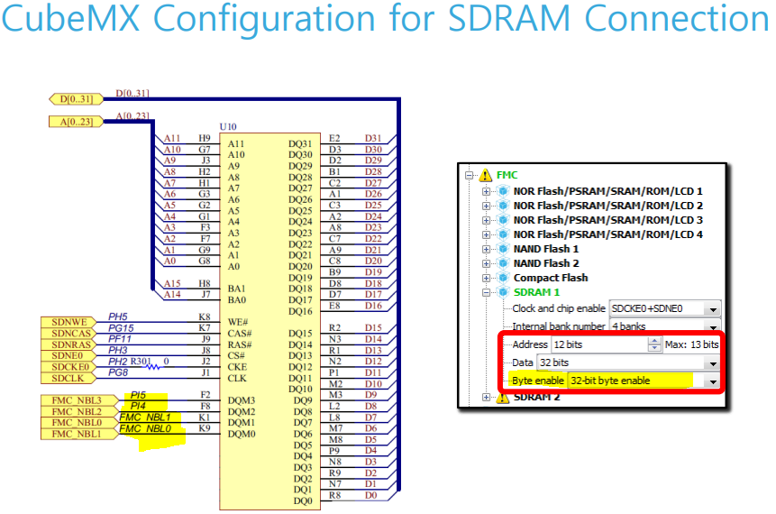

Can the FMC be configured to handle a similar configuration?
0693W00000Stn4YQAR.pngI have an SDRAM that has byte enable pins to the upper and lower bytes (Disable -> High Z), but no pins available to map the 16 bits. So, at the moment I'm working with half the memory capacity
Can the byte enable be used for this purpose in the FMC of the STM32?

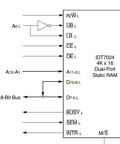

Can't you just be specific about the part(s) you're using instead of illustrating two that you aren't?
