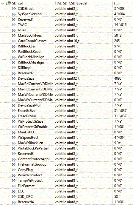

I tried all possible ways to format it (with Windows). None of them work. DiskPart can give you a bit more clue, about what goes wrong than only format command.
Only thing I did not try is to format it using qparted live cd, but I do not want to go there, as I am sure, the problem is with my implementation in the code.

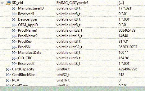

Uros Males
Posted on October 13, 2015 at 14:23
clive1, thanks for your input.
This is the card info I get from eMMC: 0690X0000060MnMQAU.gif 0690X0000060MnNQAU.gif *block_size = SDCardInfo.CardBlockSize = 512 *block_num = SDCardInfo.CardCapacity / SDCardInfo.CardBlockSize =8388608 I think I may have a problem with descriptor:

Uros Males
Posted on October 14, 2015 at 10:38
Update to the thread...
I found the problem. I forgot to wait for DMA to complete my requests...Sdio_WaitUntilDmaRdComplete(); andSdio_WaitUntilDmaTxComplete(); were missing inSTORAGE_Read_FS andSTORAGE_Write_FS
eMMC_ReadMultiBlocks(buf, blk_addr, blk_len);
I was sucessful with formatting 5MB big size, formatting 4GB is stil in progress... it takes very long time. By current estimations... cca 4 days!! And from what I found out, it is the problem with waiting for reponse flag from eMMC that DMA reading/writting was completed. Formatting is basically writing byte by byte from Windows side, not for whole block (512) in one step, but 512 steps for each block. This issue I will address with implementing Chan FatFS and trying to execute format from fw side.
