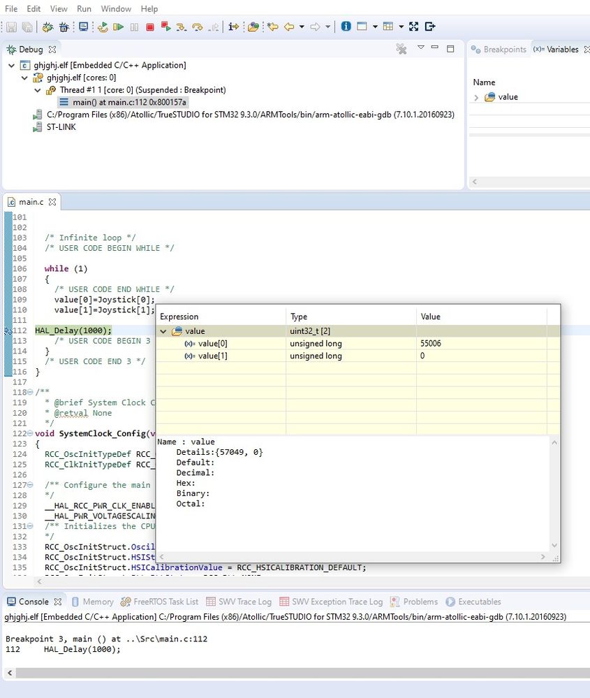

Can some one tell me why this do not work?
I start to freak out -.-..........
I wish make 4 chanel adc with dma.
Best Regards,
Szymon

I have made a test to check and I don’t have any problem.
I succeeded to read 4 analog inputs by ADC using DMA:
I used: PA0 ------> ADC1_IN0
            PA1 ------> ADC1_IN1
            PA2 ------> ADC1_IN2
            PA3  ------> ADC1_IN3
You will find attached my file main. c

Here attached my file STM32f7xx_hal_msp.c

Thx Ighor for answer :)
I really appreciate that.
& I already resolve that problem,
but I have another -.-,
can you check it?
