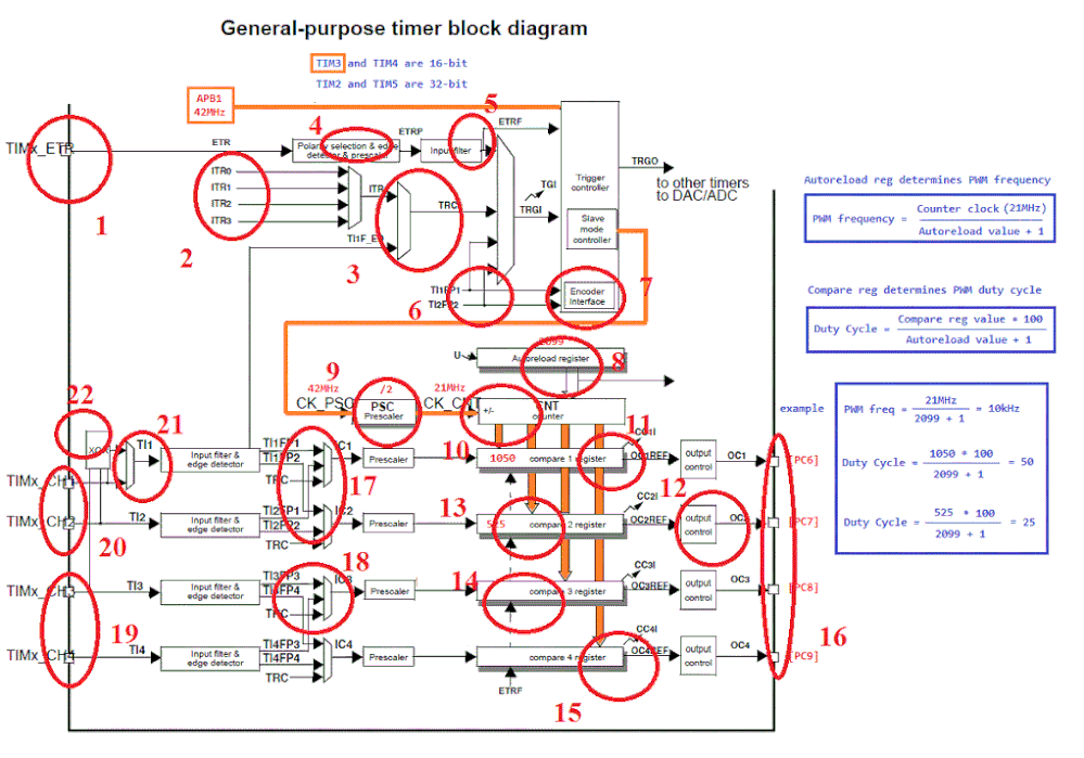

Dear All
I would like to start a discuss about STM32F4 series timers operation while learning and understanding. Please share your idea and experience to explain each red circles from number 1 in the attached picture
Any one can have an idea of operation red circles 1 in the attached picture

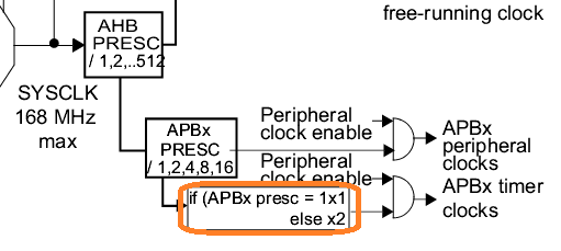

Not clocked at 42 MHz
Lot of
/public/STe2ecommunities/mcu/Lists/cortex_mx_stm32/Attachments/47046/Edge_Aligned_PWM_TIM3.png
there, nothing personal, but I'm not going to read and interpret the timer chapter(s) for you. You'll need to read the docs to yourself and decimate that significantly.

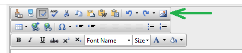

Images up to 100KB can be place in-line via the Word-in-a-box(tm) interface.
The Reference Manual is the best place to start, it's admittedly rather heavy going, but timers on most device are complicated things, trying to be all things to all people. The design has several frustrating weaknesses.
One of the first to get your head around is that there is a SINGLE counting element (ignoring the prescaler and repetition which have specific utility), the channels provide four latching/comparing elements, but do not count anything.
Another is that everything is integer, to hit specific frequencies they must neatly divide into the source clock, so you might need to run the processor at lower speeds or use magic crystals, or baby sit the timers.
Do you have experience with other timer devices, or silicon design implementation/understanding?
Yes, as you pointed out the said Manual not well documented, that is the reason I decided to start this discussion
Yes, I have enough  experience of theory and practicals for 8 bit micro controller other than ARM.
I am expecting more advice from you
Thanks in advance
