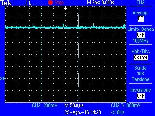

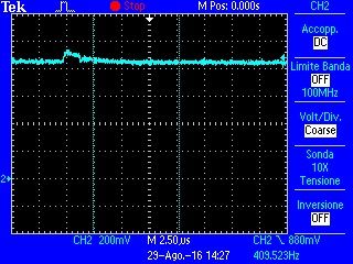

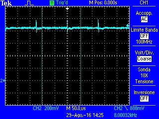

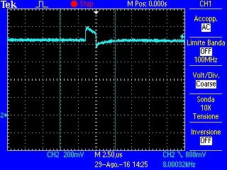

Hi, we have a problem in temperature AD acquisitions. The sensors are two Microchip MCP9700T-E/LT and are connected to ADC CH13 (pin &sharp18) end CH3 (pin &sharp26) through only a 22ohm resistance.
The ADC is triggered by a 10Khz pwm timer and is set as: // APB2-> 84MHz // L'a/d pu� andare al max a 36MHz (vedi datasheet STM32F40x) // quindi il prescaler minimo � /4 (=21MHz) ADC_CommonInitTypeDef aci; aci.ADC_Mode = ADC_TripleMode_InjecSimult; //Injected simultaneous mode only aci.ADC_Prescaler = ADC_Prescaler_Div4; aci.ADC_DMAAccessMode = ADC_DMAAccessMode_Disabled; //DMA disabilitato aci.ADC_TwoSamplingDelay = ADC_TwoSamplingDelay_5Cycles; ADC_CommonInit(&aci); // Config. modalit� conversione ADC_InitTypeDef ai; ai.ADC_Resolution = ADC_Resolution_12b; ai.ADC_ScanConvMode = ENABLE; ai.ADC_ContinuousConvMode = DISABLE; ai.ADC_ExternalTrigConvEdge = ADC_ExternalTrigConvEdge_None; ai.ADC_ExternalTrigConv = ADC_ExternalTrigInjecConvEdge_None; ai.ADC_DataAlign = ADC_DataAlign_Left; ai.ADC_NbrOfConversion = ADC_NO_OF_INJ_CH; ADC_Init(ADC1, &ai); ADC_Init(ADC2, &ai); ADC_Init(ADC3, &ai); // abilito gli ADC ADC_Cmd(ADC1, ENABLE); ADC_Cmd(ADC2, ENABLE); ADC_Cmd(ADC3, ENABLE); // configurazione canali ADC ADC_InjectedSequencerLengthConfig(ADC1, ADC_NO_OF_INJ_CH); ADC_InjectedSequencerLengthConfig(ADC2, ADC_NO_OF_INJ_CH); ADC_InjectedSequencerLengthConfig(ADC3, ADC_NO_OF_INJ_CH); The problem are the spikes that appear when starts the conversion (see attached for waveform of the two channel at mcu pin 18 and 26). This spike is exactly in the conversion instant, and then the measures are totally wrong. If we change the ADC trigger frequency, the spike moves in according to the change, but don't change if we change the other ADC sets. The only change that we have, in amplitude and in duration of the spike, is when we change the channels conversion sequence. Can you help me? Thank you- Labels:

Hi John, the MCP9700T is properly decoupled, and I don't think is an HW problem because with some specific channels conversion sequence in one pin, the spike dissapears and in the other increase. I'm sure that with an follower opamp the problem will be solved, because I haven't spikes in other channels. I would know if there is some known issue for this ADC and if there some workaround SW. I already tested the lower speed sampling and ''ADC_TwoSamplingDelay'' more than 5.
