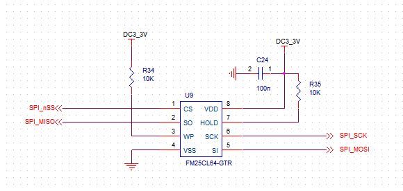

Posted on November 16, 2011 at 01:47
#define SPI2_GPIO_CLK     RCC_APB2Periph_GPIOB
#define SPI2_PORT      GPIOB
#define SPI2_CLK                     RCC_APB1Periph_SPI2
#define SPI2_SCK_PIN               GPIO_Pin_13
#define SPI2_MISO_PIN                GPIO_Pin_14
#define SPI2_MOSI_PIN                GPIO_Pin_15
#define SPI2_NSS_PIN                    GPIO_Pin_12
#endif /* USE_SPI2 */
#define DUMMY_DATA      0x11
#define F_RAM_SPI_ID     SPI2_ID
#define F_RAM_PORT      SPI2_PORT
#define F_RAM_SCK_PIN     SPI2_SCK_PIN
#define F_RAM_MISO_PIN     SPI2_MISO_PIN
#define F_RAM_MOSI_PIN     SPI2_MOSI_PIN
#define F_RAM_NSS_PIN     SPI2_NSS_PIN
#define __SPI_HW__ 1
void SPI_Low_DeInit(void)
 SPI_Cmd(SPI2,DISABLE);
 SPI_I2S_DeInit(SPI2);
void RCC_Configuration_SPI(void)
  /*!< F_RAM_SPI_CS_GPIO, F_RAM_SPI_MOSI_GPIO, F_RAM_SPI_MISO_GPIO
       and F_RAM_SPI_SCK_GPIO Periph clock enable */
#ifdef USE_SPI2
 RCC_APB2PeriphClockCmd(SPI2_GPIO_CLK | RCC_APB2Periph_AFIO, ENABLE);
 RCC_APB1PeriphClockCmd(SPI2_CLK, ENABLE);
#endif
void GPIO_Configuration_SPI(void)
 GPIO_InitTypeDef GPIO_InitStructure;
#ifdef USE_SPI2
 /*!< Configure F_RAM_SPI pins: SCK */
#ifdef __SPI_HW__
 GPIO_InitStructure.GPIO_Pin = SPI2_SCK_PIN | SPI2_MOSI_PIN;
 GPIO_InitStructure.GPIO_Speed = GPIO_Speed_50MHz;
 GPIO_InitStructure.GPIO_Mode = GPIO_Mode_AF_PP;
 GPIO_Init(SPI2_PORT, &GPIO_InitStructure);
#elif __SPI_SW__
 GPIO_InitStructure.GPIO_Mode = GPIO_Mode_Out_PP;
#endif /* __SPI_HW__ */
 GPIO_InitStructure.GPIO_Pin = SPI2_MISO_PIN;
 GPIO_InitStructure.GPIO_Mode = GPIO_Mode_IN_FLOATING;
 //GPIO_InitStructure.GPIO_Mode = GPIO_Mode_AF_PP;
 /*!< Configure F_RAM_CS_PIN pin: F_RAM Card CS pin */
 GPIO_InitStructure.GPIO_Pin = SPI2_NSS_PIN;
void SPI_Configuration(void)
#ifdef __SPI_HW__
 SPI_InitTypeDef  SPI_InitStructure;
 /*!< Deselect the F-RAM: Chip Select high */
 //F_RAM_HOLD_HIGH();
 F_RAM_CS(Bit_SET);
#ifdef USE_SPI2
 SPI_InitStructure.SPI_Direction = SPI_Direction_2Lines_FullDuplex;
 SPI_InitStructure.SPI_Mode = SPI_Mode_Master;
 SPI_InitStructure.SPI_DataSize = SPI_DataSize_8b;
#if 0
 SPI_InitStructure.SPI_CPOL = SPI_CPOL_Low;
 SPI_InitStructure.SPI_CPHA = SPI_CPHA_1Edge;
#else
 SPI_InitStructure.SPI_CPOL = SPI_CPOL_High;
 SPI_InitStructure.SPI_CPHA = SPI_CPHA_2Edge;
#endif
 SPI_InitStructure.SPI_NSS = SPI_NSS_Soft;
#if 0
 SPI_InitStructure.SPI_BaudRatePrescaler = SPI_BaudRatePrescaler_16;
#else
 SPI_InitStructure.SPI_BaudRatePrescaler = SPI_BaudRatePrescaler_8;
#endif
#if 0
 SPI_InitStructure.SPI_FirstBit = SPI_FirstBit_LSB;
#else
 SPI_InitStructure.SPI_FirstBit = SPI_FirstBit_MSB;
#endif
 SPI_InitStructure.SPI_CRCPolynomial = 7;
 SPI_Init(SPI2, &SPI_InitStructure);
 /*!< Enable the sFLASH_SPI  */
 SPI_Cmd(SPI2, ENABLE);
void main(void)
 SPI_Low_DeInit();
 GPIO_Configuration_SPI();
 RCC_Configuration_SPI();
 SPI_Configuration();
u8 F_RAM_SendByte(u8 byte)
 u8 ret;
   /*!< Loop while DR register in not emplty */
   while (SPI_I2S_GetFlagStatus(F_RAM_SPI, SPI_I2S_FLAG_TXE) == RESET);
   /*!< Send byte through the SPI1 peripheral */
   SPI_I2S_SendData(F_RAM_SPI,(u16)byte);
 /*!< Wait to receive a byte */
 while (SPI_I2S_GetFlagStatus(F_RAM_SPI, SPI_I2S_FLAG_RXNE) == RESET);
 /*!< Return the byte read from the SPI bus */
 ret = (u8)SPI_I2S_ReceiveData(F_RAM_SPI);
 return ret;
    2 replies

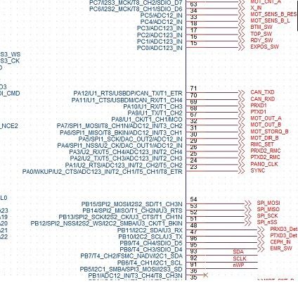

    Posted on November 16, 2011 at 02:16
    You'll need to be enabling the clocks on the peripherals if you want the settings to work.
    ie RCC before GPIO

    change RCC and GPIO.
    but not active spi2.
    schmetic is ...
