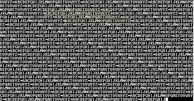

For more detail .I'll write two program here one of them works good but the next one data will corrupt . i'll attach the result picture;
---------------------------------1-Ok----------------------?
void
SPI2_IRQHandler(
void
            if( SPI2->SR & SPI_SR_TXE ){
                SPI2->DR =
0xFF
            if( SPI2->SR & SPI_SR_RXNE ){
                stringBuffer[counterInMaster] = SPI2->DR;
                counterInMaster++;
                if(counterInMaster >
25
                    counterInMaster =
0
                    stringBuffer[
26
\0
                    send2Usart2(stringBuffer);

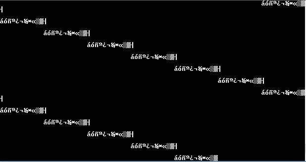

------------------------------2-corrupt----------------------?
void
SPI2_IRQHandler(
void
                SPI2->DR =
0x41
any character lead to corrupting data
                counterInMaster++;
25
                    counterInMaster =
0
                    stringBuffer[
26
\0

Posted on January 28, 2017 at 20:03
Thank you . I took your point . But there is something else here that i can't understand. If my procedure is wrong why in first program it works fine (when i put 0xFF in tx slave buffer ) and when i put any other letter or character in Slave Buffer data will corrupt ?
And i tried other program ( A lot i mean. I'll put one of them below ) for example I sent some data from Master and in Slave side just send character 'A' .When transferring data from Master to Slave has finished i disabled interrupt and after that sent data to UART but the problem still exists...↓
-------------------------Problem still exists ------------------------------↓

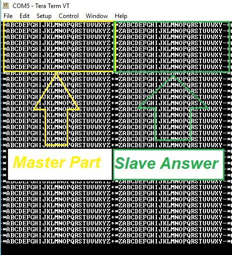

M N
Posted on January 29, 2017 at 11:26
Both are config in full duplex . Both has same configuration in pin or other configuration just one of them is Master and the other one is Slave . If i send 0x00 or any thing else slave will receive it , Until i don't write any letter or character to Slave Tx buffer .
The meaning and reason of Interrupt or Polling is not important here . As i write another program below this post that i disabled interrupt and send data to USART so it's not any more important we are in interrupt because we are in polling mode after disabling .
My question is why data is Ok when i write 0xFF or 0x00 in Data Register in Tx buffer empty time in Slave but will corrupt when ill write any other character ? i want to write data to tx buffer and transmit it when data is coming from master but it won't work !? how can i do this ?
Posted on January 29, 2017 at 16:44
I'm using STM32F407 and Both Master and Slave are in one MCU ( but i test it on two board also ).
I've tested different clock frequency (fpclk/2 ....fpclk/256).And interconnection is not too long because both spi are in same microcontroller in one board . Ground is Ok.Unfortunately i do not have oscilloscope or logic analyzer.
the code is :↓

Now It's the result : ?
Decreasing speed
setting in OSPEEDR has worked .! How did you know that ? I read reference manual a lot and very carefully (i tried) . But i didn't realize that point.
