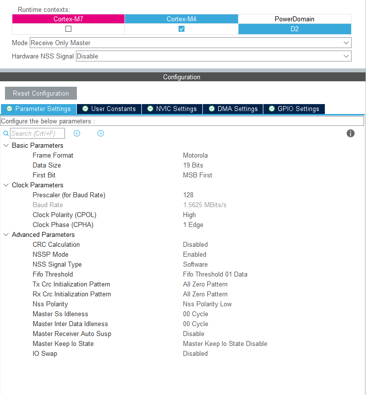

I am working with the dual core stm32h745 nucleo board, currently on the M4 core.
here are the defenitions in cubeMX:
the defenition is for a recieve only master which belongs to the m4 cortex.
while trying to use HAL_SPI_Receive_IT() or HAL_SPI_Receive() i am not able to get HAL_OK status. the board isnt connected to any other hardware and i am trying to see that i am ok on my side.
my actions are pretty straight fowards, could you please advise on what i might be doing wrong and what can create such a problem ?
thank you!
So what do you get instead?
Show your code, likely a software issue, perhaps the peripheral isn't being initialized. You can step through HAL_SPI_Receive to see what it objects to.

Hi!
the  MX_SPI1_Init() function returns a HAL_OK status and seems to go fine.
when i use the HAL_SPI_Receive() the status returned is HAL_ERROR.
when i use the HAL_SPI_Receive_IT() the status returned is HAL_OK for the first call and then its always HAL_BUSY.
after expiriencing these issues i have created a very simple test project using CubeMX,

i have noticed something a bit disturbing, the SPI readings were successful on the M7 core,
when i tried the same on the M4 core they all failed as describe above.
perhaps this can give a clue about whats going on?

I'm sorry, i've put up the wrong code, i am using HAL_SPI_Receive() and also as i said tried HAL_SPI_Receive_IT().
in both cases while observing the clk line on the scope i saw that:
on the M7 - a clock is generated and the status from function is HAL_OK.
on the M4 - no clock sinal is generated, the clock goes high for a short time and goes low again.
i am currently using the receive only master, i will try what you suggested to use the full spi.
in the meantime could you think of a reason why something that works on the M7 does not work on the M4?
