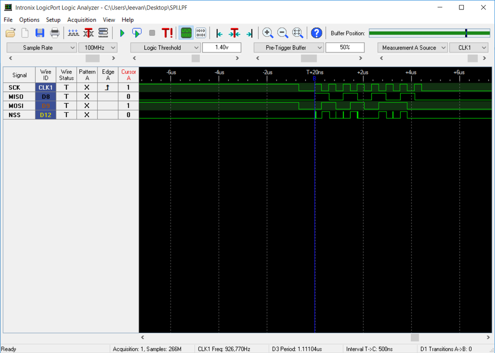

We are trying to communicate ST disco board with atmel board  using example code of SPI.
We have configured spi clock frequency 500000hz
clock phase and clock polarity as zero, in atmel board.
where to configure spi clock in ST board.
where to configure CS line and which pin num is used in STM32F769I disco board

Posted on December 07, 2017 at 05:21
We are trying ST as master and slave both,
its 4 wire line.
We connected between
ST Atmel
SCK SCK
MOSI MOSI
MISO MISO
x CS
x ---> don't know which pin to use in STM32F769NI Disco board ,for nucleo board i am not finding SPI examples.
we are using 5 mHZ spi clock frequency in ATlmel board,but i don't know where we need to configure theSPI clock in ST board and what SPI clock frequency its using and what SPI baudrate need to set.
how to use CS manually what is the necessity and when to use
SPI_NSS_SOFT
SPI_NSS_HARD_INPUT
SPI_NSS_HARD_OUTPUT
Output we have attached please look into it the NSS we are not getting properly either low or high.

Posted on December 07, 2017 at 12:54
Use
SPI_NSS_SOFT and control NSS as if it is a normal GPIO, by SW.
Get NSS low before launching the transfer and wait that the transfer is really completed (RXNE completed and cell is not BUSY).
There should be SPI Examples for the corresponding Nucleo board.
For the wirering, it looks ok. Also, I recall there are 2 SPI modes, the general one and TI mode. Thanks to check how Atmel Slave SPI is configured to match.
Posted on December 08, 2017 at 09:33
how to make NSS low if you have any example code for disco board can you send it.
Posted on December 11, 2017 at 13:48
can i know what is the spi clock frequency we need to configure,
where we need to configure SPI clock frequency in ST disco board
In atmel board we are recieving 50000 hz spi clock frequncy
