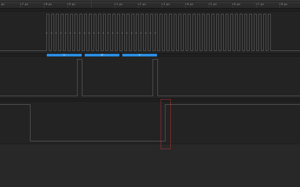

hi,I want use SPI1 as master and SPI1 reg configure as that
    SPI1->CR2 =
0x1704
;     SPI1->CR1 =
0x15C
read code is
    GPIOA->BSRR |=
1
20
//set NSS low
for
(i =
0
;i < command_size;i++)
while
0
== (SPI1->SR & SPI_SR_TXE));         SPI1->DR = out_buf
i
0xFF
while
0
== (SPI1->SR & SPI_SR_RXNE));         in_buf
i
= SPI1->DR &
0xFF
    GPIOA->BSRR |=
1
4
//set NSS high
i use logic analyzer capture the logic as
it saw that clock also driver after NSS set high.
can anyone help me

Release NSS only when SPI BUSY bit is cleared.
Posted on March 10, 2017 at 10:00
thank you for reply, my problem is that when i send 3 bytes but it have 48 clocks
