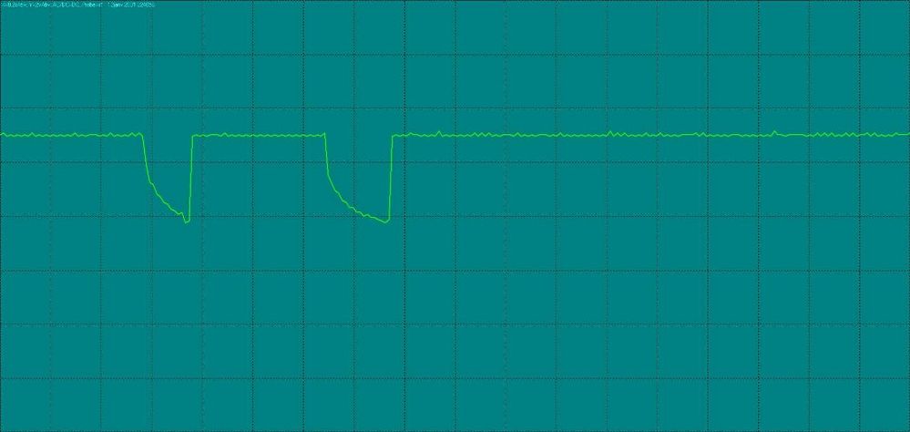

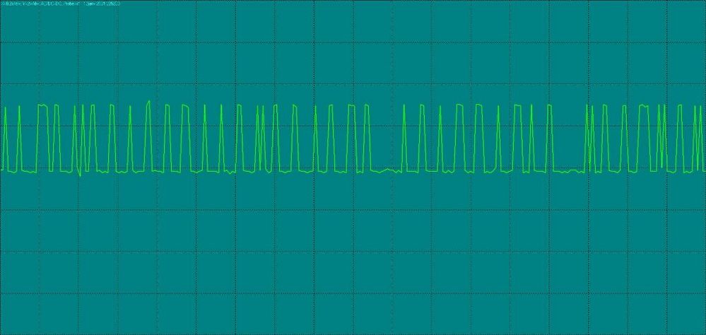

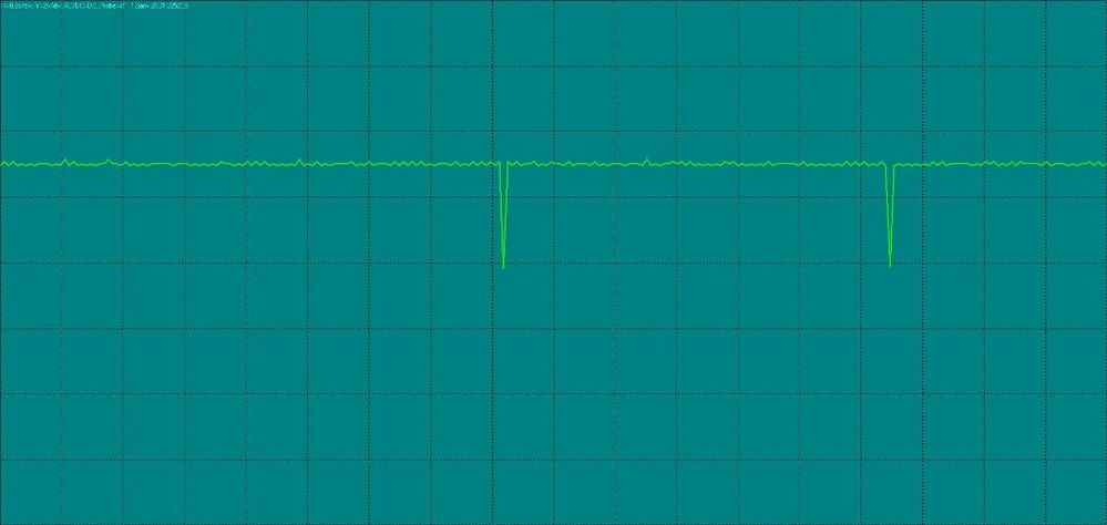

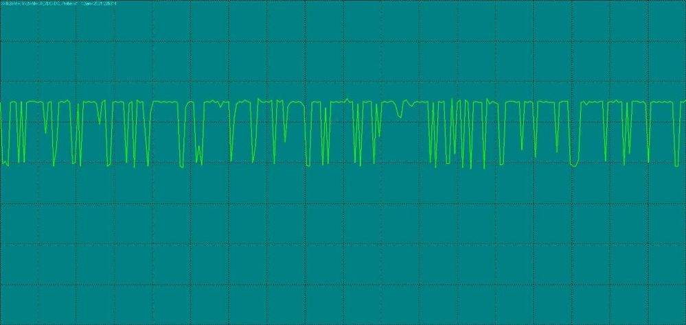

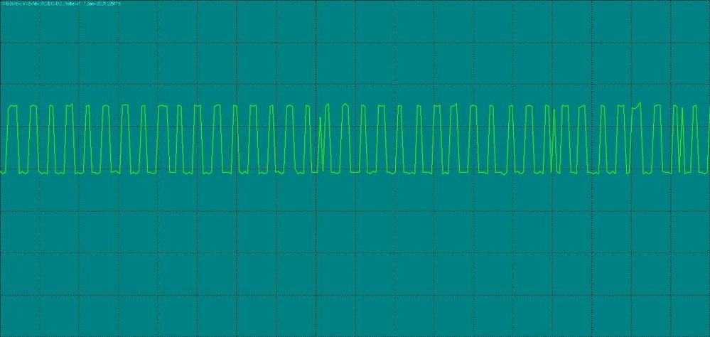

samcharnet
Posted on January 25, 2013 at 16:58
And this is screenshot from all pins
SCK seems broken. If i am right, there should be one pulse per bit ?
Reset :
CS :
DC :
MOSI :
And SCK :
waclawek.jan
Posted on January 25, 2013 at 18:03
What kind is the scope you used? It would be nice to know the timebase, too.
While the slow rising/falling edges and missing pusles might be the limitation of the scope/probe, it is suspicious. Why are there two pulses on Reset? And why that outrageously slow trailing ''edge''? Some of it might be attributed also to
GPIO_InitStructure.GPIO_Speed = GPIO_Speed_2MHz;
which you should revise; but it's still suspicious. It also appears that you have messed up the pins somehow. While SCK and MOSI should toggle like crazy, CS should pulse once per byte and DC - depending on your code - should be mostly static. JW
samcharnet
Posted on January 25, 2013 at 18:52
I use a velleman hps 40 (10Mhz) with rs232 software for screenshot, the timebase is on the top of the picture. In this case : 0.2s, 2V
The double reset is ok, I have pressed twice the button. DC is not static, it take high for sending command and low for sending data I checked again all connexion, it's ok, like the list I have posted before. I just tested the

samcharnet
Posted on January 25, 2013 at 21:38
In fact, I can see SCK pulses at 125ns/div.
The result is crapy but coherent. I will look for a better oscilloscope if I want to check pin synchronisation..
I have tried with a software spi on same pins, the result is the same, the display still black. Can I deduce it is not a spi probleme ?
