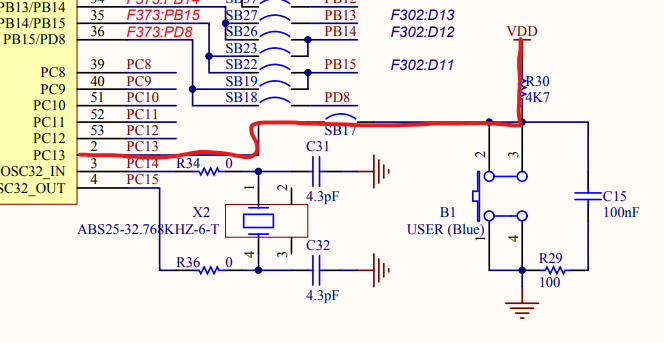

Solution: Just like TDK said, PC13 pin is active high (can be seen below).

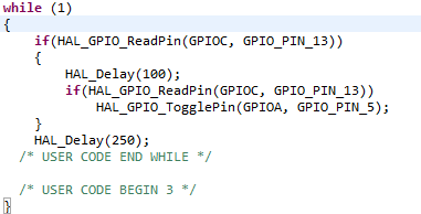

This time when we wrote a basic input command something was off. System works completely opposite of it is supposed to work.0693W000006GNEMQA4.png0693W000006GNEHQA4.pngCode and settings are this. Normally led on the board isn't supposed to blink on it's own but it is doing that on all boards. We have changed the input pin but it didn't worked. (it somehow started to work with PC3 but still fails to work with PC13). Schematics of the board also reveal that it is a normally open button.
0693W000006GNEgQAO.pngI'm not sure why all boards are doing this weird thing. Same code (when uploaded to 407VG) doesn't do this but wait for an input (in that case also the blue user button). What is wrong with the system ?
PC13 is idle high. You need to check for a low voltage when the button is pressed. Probably also shouldn't have a pulldown enabled but it's not affecting the circuit much due to the external 4.7K pullup.
Oh wait that is my bad sorry, should have checked buttons connections :( Thank you!
