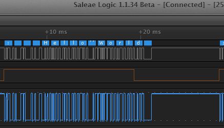

childresss
Posted on February 05, 2015 at 00:29
Logic Analyzer screen grab.
Top: Half-duplex/smartCard UART TX/RX serial.
Next down: GPIO bit my code sets before calling transmit_IT, cleared in TXcomplete call-back.
Bottom: Analog signal corresponding to the UART TXRX data line.
Means: TC interrupt occurs when last 2 bytes loaded into UART but before the serial shift register and the TDR (last 2 bytes) have actually flowed on the serial line, and the 20th stop bit has finished.
you mean at the TC interrupt?

Posted on February 05, 2015 at 21:56
So I did not listen to myself and dug into Cube and IMO I found a bug. I am not going to test the fix, though; it's up to you.
In [STM32Cube_FW_F4_V1.4.0]\Drivers\STM32F4xx_HAL_Driver\Src\stm32f4xx_hal_smartcard.c in HAL_SMARTCARD_IRQHandler() (which is apparently the ISR in question), first, USARTx_SR is read into tmp1, then, in an ugly copypasted spaghetti of code, for the various interrupt sources, the interrupt enable flag is read into tmp2 using __HAL_SMARTCARD_GET_IT_SOURCE() (yes, the name is deceiving, it does not get the ''interrupt occured'' *flag*, but the interrupt *enable flag*). Then, for all other sources, tmp1 is masked for the expected flag and compared to zero called RESET in the ''libraries'', while tmp2 is directly compared to zero. But, for TC, both tmp1 (without masking) and tmp2 is compared to zero. Thus, as soon as TC is enabled, the first flag which goes high (TXE, for example) causes SMARTCARD_EndTransmit_IT() to be called, which in turn calls HAL_SMARTCARD_TxCpltCallback(), which is the callback you are probably overriding with your code.
(I looked into the UART and IRDA handlers, they do things differently - they read and mask the _SR bits as well as the enable bits explicitly before each check for the individual sources. Uglier.)
So the fix is, add the proper masking of tmp1 for checking of TC by the end of HAL_SMARTCARD_IRQHandler()
Enjoy.
childresss
Posted on February 06, 2015 at 01:44
You are correct!!
I looked at that code for a long time and didn't see that coding mistake they made.
The 'scope shows the timing is correct now, after I put in your recommendation:
// was  if((tmp1 != RESET) && (tmp2 != RESET))
  if (((tmp1 & SMARTCARD_FLAG_TC) != RESET) && (tmp2 != RESET))
