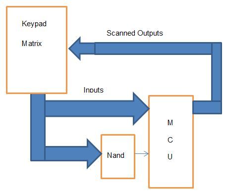

Above is the general scheme - keypad is driven by your 6 ''outputs'' - and 8 keypad inputs are routed both to the Nand Gate & to the MCU.
Biggest job for MCU SW is the ''read'' of the keypad - which now can be confined to, ''only when a keypress has been detected!''  (via the Nand gate generating an interrupt)
All outputs must default ''low'' - so that any keypress will transfer that low onto the MCU.  The interrupt will then make a call to Keypad Scan Routine - which will drive one and only one of the keypad outputs successively low - enabling your matrix decode.
You can reduce GPIO usage by using a shift register to generate those keypad outputs.  In this case I would configure the keypad for 8 outputs - 6 inputs.  Again - shift register must default w/all outputs clocked low - which enables the Nand gate's detection of any keypress.  In this case - the Keypad Scan must generate the ''walking low'' via the shift register - thru a series of outputs to the shifter.  It will likely cost 3 GPIO to transact w/the shifter - netting you 5 GPIO.  You trade ease of programming - and decode speed - for the conservation of GPIO...
Should add that all input lines must be pulled ''high'' - either by external pull-up Rs or by MCU's internal - as/if present.  Keyswitch closure will then transfer the MCU's output low onto the MCU inputs and Nand Gate - enabling key detection and matrix-position solution...
