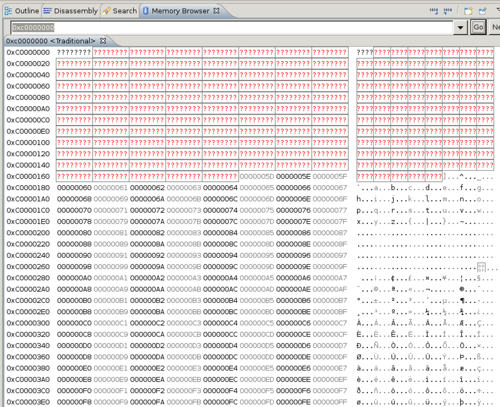

I changed the WRITE_ADDR (offset) to 0x0 (i.e. start at 0xc0000000) and the test values start at 0 and are increment by 1 for each offset.
Using the debugger I am seeing the memory dump below (in System Workbench), which is promising, but why the red ??'s  ?

I'd probably look at what's going on with PE15 (D12), and SB57.
Sorry not a board I have.
Posted on January 16, 2017 at 15:48
Thanks Clive,
It was a combination of a short on D12 and also the CubeMX project remapping the SDRAM Write line from PH5 to PC0 (as well as a couple of other pins)
The cause of the pin remap was either due to fat fingers on the  'Pinout' and/or 'Pin Config' window in CubeMX and/or not electing 'Keep Pin Assignments'   -   A PICNIC error either way.
