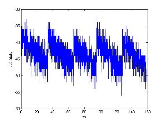

I meet a problem with my project in which a STM32F373 MCU is used to collect singnal in single-ended mode.I short the pin with GND to test the board,the ADC values I get seems to fluctuate like saw-tooth.0690X00000603BzQAI.jpg
The graph above shows what I get with my board.The signal is moving averaged.
But if I chang SDADC module into differential mode,the saw-tooth liked pattern disappears.
The single passes through a RC network before it arrives at the SDADC pin.
Has anyone encountered such a prolem?
Thanks

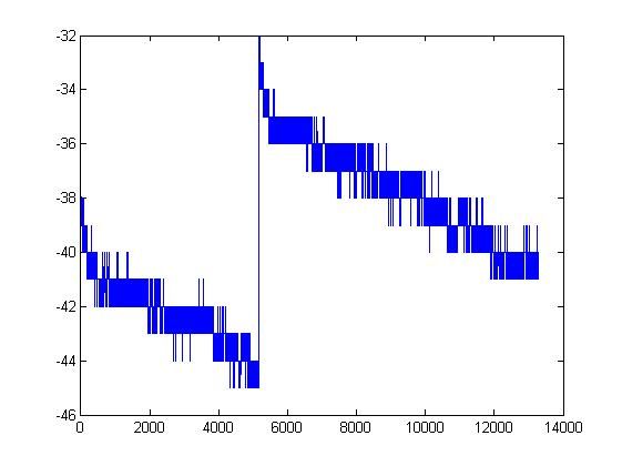

I when debug my code,I could see the data fluctuates in KEIL MDK as the graph showed.

You're showing less than a single cycle of the sawtooth.  Can you show a larger sample, perhaps 3 or 4 cycles?
What does the signal that you're trying to capture look like?  Have you verified with an oscilloscope that it is what you expect it to be, both before and after the RC network?
Does the SDADC have a very high input impedance?  Is it possible that your RC network is being loaded down by a low-impedance ADC input and distorting the signal in unexpected ways?

Sorry for that small data,larger sample is showed in the attached picture.
Currently,I just short the signal input with GND.Thus,the captured data should show a shape as straight line with a narrow variation range.
As for the SDADC impedance you mentioned, I have changed the SDADC CLOCK and GAIN setting sevaral times to change the input impedance,but the results stay the same.
By the way,from the picture attached, it can be seen that the sawtooth cycles at a certain period,about 30s. This is puzzling.

It may simply be noise - consider that +/-35 or so is only 0.1% of full scale for an int16.  That could easily be caused by variations in Vref or power supply.
Maybe try feeding the circuit with an actual signal, say a 1Vp-p sine wave, and see how it behaves.

There are cases where the data is free of saw-tooth variations,but not many.When I put the SDADC into differential mode, the saw-tooth also disappears. In my opinion,if it is noise, it should not totally disappear in differential mode.And if it is something like common-mode interface, why it dose not come up every time absolutely ?

Given that it disappears when you use the ADC in a differential mode, I would say it's almost certainly noise.  My guess is still power supply noise; did you supply your F3's analog section with relatively quiet power and reference voltage, either or both by passive filtering or a separate low-noise regulator?

Have you inspected the user manual carefully, with particular attention to the electrical characteristics of the SDADC?  p110 of v7 indicates that you should expect a typical offset error of around 2mV in single-ended mode, which is in the ballpark of what you're seeing.  That thought is backed up by the typical offset error in differential mode of around 100uV, which matches up to your seeing little or no noise in differential mode.
I don't suppose you could post your circuit schematic, at least of the analog section?
