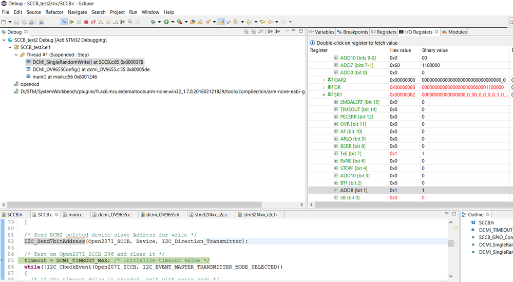

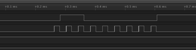

I have a problem with I2C (SCCB) communication. More precisely, when i try to send slave write adress (0x60 - from 0v9650 datasheet), I get ''DONT_CARE_BIT'' = FALSE. It's like ACK, so after this ADDR flag in I2C_SR1 is set..
BUT.. When i go to line:
while(!I2C_CheckEvent(I2C1, I2C_EVENT_MASTER_TRANSMITTER_MODE_SELECTED))
and don't do this yet the ADDR flag is reset and it gets stuck because ADDR flag isn't set.
What can be the reason of reset ADDR?
screen from logic analyzer:

I know I2C and SCCB build.
In OV9650 datasheet is written:
''The device slave addresses are 60 for write and 61 for read.''
So I suppose that this ''1'' is 8-bit (''read'' bit).
I have set OwnAddress1 on 0xC0 and this fill OAR1 register correct. (look screen)
In STM32F4 RM is written that ADDR flag is set after ACK and this is reset only when:
- after SR2 and SR1 register
- or when PE=0
In my case neither of these options doesn't occur. This flag is just SET after send 7-bit address and RESET before i check this in while loop.
I'm still looking reason why ADDR flag is reset.
