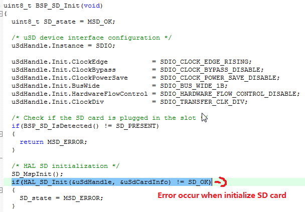

STM32Cubemx can generate the code for you, however, I never succeed in accessing uSD with the code generated by cubemx. In my own board I have a STM32F411RC chip. In order to study uSD, I have aF4 discovery board with BB board to test uSD. A testing code was utilized to test the hardware to ensure that the hardware has no problem. The code generated by cubemx for uSD is attached. Only a few sentences were added to the main() function. I couldn't find any problem in the code. At debuging, it stops at the line:if
(f_open(&MyFile, filename, FA_CREATE_ALWAYS | FA_WRITE) != FR_OK)
//note filename length should be <=8
Anyone, please help to check the code. All project files are attached.
Only main.c file is posted on page to view. Others files were generated by cubemx, not changed at all.
Or please generate a simple sample code for STM32F411RC to access uSD.
I have been struggling for a few days.
Really appreciate for suggestions and help.

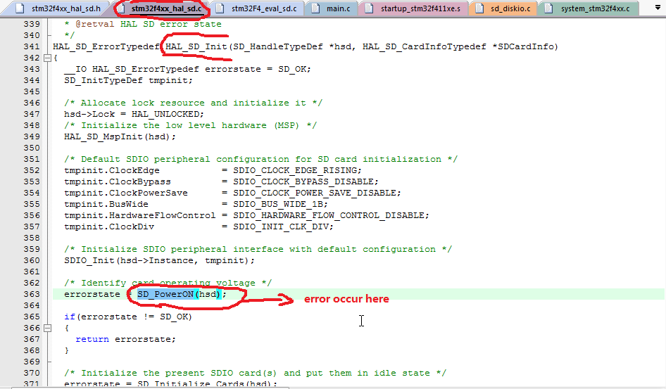

Update of the code.
I switched the board from STM32F4 discovery to F411RC chip(my own board). And did the following changes. 1. Using Cubemx to generate a template project with chip F411RC. 2. Change group files using the one which was tested on F4 discovery board with uSD card. I am sure all the files are correctly replaced. 3. system_stm32f4xx, startup_stm32f411xe.s were copied from the template found in the resp folder. 4. stm32f4xx_hal_conf.h file was generated by stm32cubemx, in which module was double checked to make sure necessary modules were enabled. 5. Clock setting was updated as following.void

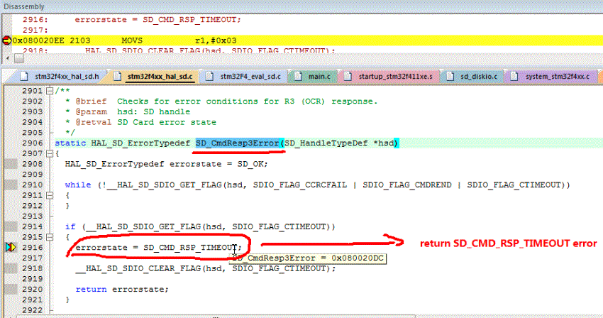

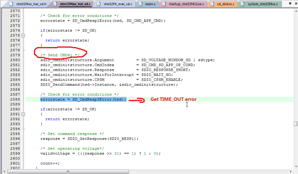

Now I test the uSD. Find there is problem in

I really have no insight into your board design, or clocks. Right now it kind of suggests a connectivity issue with the SD Card, and perhaps clocks.
I can't help you with HAL stuff, and whether that works out of the box, or not.Up vote any posts that you find helpful, it shows what's working..
‎2015-10-22 4:19 PM
Maybe it is caused by speed. When I debug one line by one line, it seems OK.
How can I reduce the SDIO speed? Thanks- Mark as New
‎2015-10-22 8:09 PM
The primary clock is from the Q tap of the PLL, the one controlling the bus is the ClockDiv parameter for the SDIO. The initialization speed is 400 KHz, and most microSD cards should be clockable at 24 MHz
