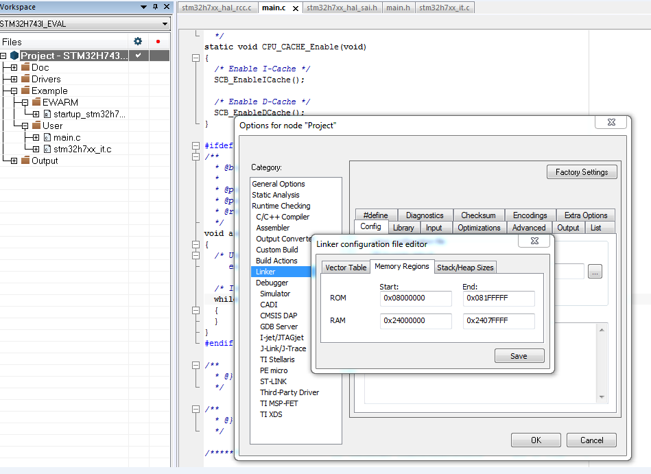

The H7 is more complex than any other STM32 part, DMA has new routing options, there may be issues with specific memory locations. DMA 'Error' conditions typically revolve about using an address that is not supported. Check the bus matrix diagrams for memory/bus connectivity, and the DMA channel matrix. Try different SRAM blocks.

,The problem that you have,it may
be due to an error in the DMA configuration. The configuration of
STM32F7 is not the same as inSTM32H7.
You should check the
DMA configuration,DMA stream notion and channel which are different. Also the DMA request should be enabled for STM32H7.
For STM32H7, the adress
@0x20000000 DTCM is not accessible by the DMA.
You may refer to the reference manual to check the right adress on section ''Embedded SRAM
''.I suggest that you have a look to the working SAI example within STM32CubeH7 firmware package, it may help you:
STM32Cube_FW_H7_V1.2.0\Projects\STM32H743I_EVAL\Examples\SAI

‎2018-05-30 2:30 AM
Hai Imen D.,.,
Yes it is ri8 , the problem resolved by changing the RAM address area, Now its working fine, Also I found some bugs in Cube MX while generating code for ethernet interface,
