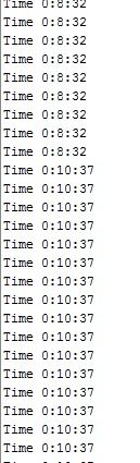

I'm running RTC on LSI Clock and transmitting data via UART2 but the RTC is not displaying updated values but while on reset it is showing updated values as shown in below image.

// Gobal Variable's
RTC_HandleTypeDef hrtc;
UART_HandleTypeDef huart2;
RTC_TimeTypeDef Time;
char Buff[30];
void SystemClock_Config(void)
  RCC_PeriphCLKInitTypeDef PeriphClkInit = {0};
  /**Configure the main internal regulator output voltage
	__PWR_CLK_ENABLE();
  __HAL_PWR_VOLTAGESCALING_CONFIG(PWR_REGULATOR_VOLTAGE_SCALE1);
  /**Initializes the CPU, AHB and APB busses clocks
  RCC_OscInitStruct.OscillatorType = RCC_OSCILLATORTYPE_LSI|RCC_OSCILLATORTYPE_MSI;
  RCC_OscInitStruct.LSIState = RCC_LSI_ON;
  RCC_OscInitStruct.MSIState = RCC_MSI_ON;
  RCC_OscInitStruct.MSICalibrationValue = 0;
  RCC_OscInitStruct.MSIClockRange = RCC_MSIRANGE_5;
  RCC_OscInitStruct.PLL.PLLState = RCC_PLL_NONE;
    Error_Handler();
  RCC_ClkInitStruct.SYSCLKSource = RCC_SYSCLKSOURCE_MSI;
  RCC_ClkInitStruct.APB1CLKDivider = RCC_HCLK_DIV1;
  RCC_ClkInitStruct.APB2CLKDivider = RCC_HCLK_DIV1;
  if (HAL_RCC_ClockConfig(&RCC_ClkInitStruct, FLASH_LATENCY_0) != HAL_OK)
    Error_Handler();
  PeriphClkInit.PeriphClockSelection = RCC_PERIPHCLK_USART2|RCC_PERIPHCLK_RTC;
  PeriphClkInit.Usart2ClockSelection = RCC_USART2CLKSOURCE_PCLK1;
  PeriphClkInit.RTCClockSelection = RCC_RTCCLKSOURCE_LSI;
  if (HAL_RCCEx_PeriphCLKConfig(&PeriphClkInit) != HAL_OK)
    Error_Handler();
  * @brief RTC Initialization Function
  * @param None
  * @retval None
static void MX_RTC_Init(void)
  /* USER CODE BEGIN RTC_Init 0 */
  /* USER CODE END RTC_Init 0 */
  /* USER CODE BEGIN RTC_Init 1 */
  /* USER CODE END RTC_Init 1 */
  /**Initialize RTC Only
  hrtc.Instance = RTC;
  hrtc.Init.HourFormat = RTC_HOURFORMAT_24;
  hrtc.Init.AsynchPrediv = 124;
  hrtc.Init.SynchPrediv = 295;
  hrtc.Init.OutPut = RTC_OUTPUT_DISABLE;
  hrtc.Init.OutPutRemap = RTC_OUTPUT_REMAP_NONE;
  hrtc.Init.OutPutPolarity = RTC_OUTPUT_POLARITY_HIGH;
  hrtc.Init.OutPutType = RTC_OUTPUT_TYPE_OPENDRAIN;
  if (HAL_RTC_Init(&hrtc) != HAL_OK)
    Error_Handler();
  /* USER CODE BEGIN RTC_Init 2 */
  /* USER CODE END RTC_Init 2 */
int main(void)
  HAL_Init();
  SystemClock_Config();
  MX_GPIO_Init();
  __HAL_RCC_RTC_ENABLE();
 MX_RTC_Init();
 HAL_PWR_EnableBkUpAccess();
  MX_USART2_UART_Init();
  while (1)
			HAL_RTC_GetTime(&hrtc,&Time,RTC_FORMAT_BIN);
			sprintf(Buff,"Time %d:%d:%d\n",Time.Hours,Time.Minutes,Time.Seconds);
			HAL_UART_Transmit(&huart2,Buff,strlen(Buff),100);
			HAL_Delay(500);
