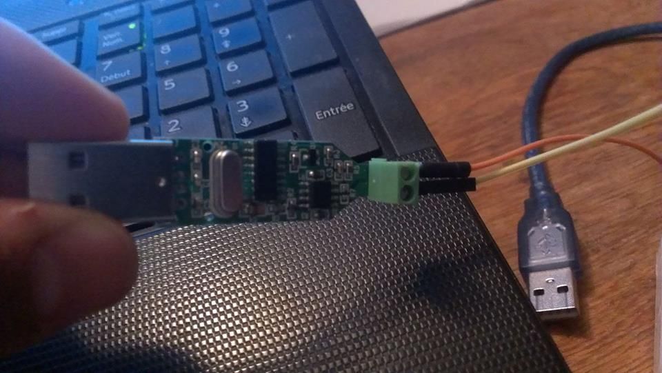

    sak hos
    sak hosAuthor
    June 18, 2017
    Posted on June 18, 2017 at 20:33
    i declared as information to send a uint8_t with a value 0x22 or 0xBB
    i'm using half dubplex and i putted DE and RE to High level (to use max485 as transmitter ) i added a picture of my RS485/USB adaptaer, it's small circuit wich use a MAX485 and CH340G
    Tesla DeLorean
    Guru
    June 18, 2017
    Posted on June 18, 2017 at 21:02
    The settings would need to be coherent.
    Send a stream of 'U' characters, review the signalling on the scope, verify the bit timings,etc.
    Make sure the HSE, HSE_VALUE, and PLL setting are correct, and that you can verify the clocks with a scope.
