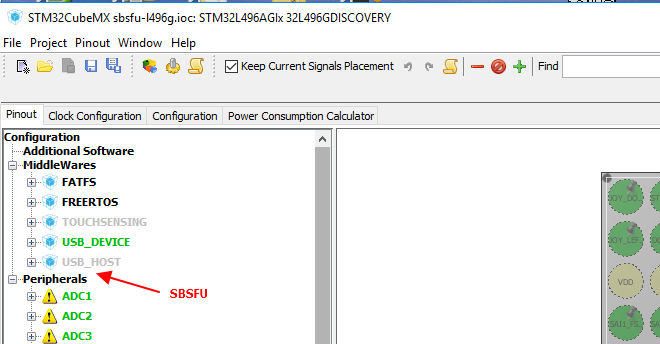

We have SBSFU working well on the NUCLEO-L476RG, and it's great.
We are using IAR EWARM 8.22.   All is fine provided we are using the
NUCLEO-L476RG.
We have tried to port the package to a P-L496G-CELL02.
We changed a the processor type in the project, and everything built fine.
It installed and appeared to run fine, with console messages indicating that the secure engine was initialised correctly, and SBSFU then tried to receive firmware via YMODEM.
At this point, things failed.  No YMODEM packets were transferred.  Maybe there are some differences in the comms hardware between the two boards.
My question is, in future is there a plan to add support for SBSFU to STM32CubeMX, like the image below, to simplify the setup?
Thanks
Tim
Posted on June 04, 2018 at 15:51
Hi Tim. Thank you for reply.
I hope you'll manage to run Ymodem on P-L496G-CELL02.
Did you try Ymodem fix I mentioned before?
Regarding SBSFU support for STM32CubeMX:
I think there are two types of packages required: SBSFU_bootloader and SBSFU_application.
SBSFU_application should be enabled for user applications.
It should update SystemInit() function with appropriate SCB->VTOR value. Currently it is manual process described in Figure 38 of UM2262 document.
It could also maintain slot addresses in linker files.
SBSFU_bootloader should be enabled for user defined SBSFU bootloaders.
For selected project it should add necessary libraries, linker definitions, keys etc.
This could really simplify process of creating own SBSFUs bootloaders.
Best wishes
