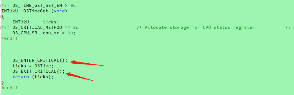

Hi,Master:
Question 1:
As shown in the figure below, why does the api read this variable with critical protection?
0693W00000GXyJiQAL.pngQuestion 2:

1) It is unnecessary as reading int32_t is atomic. You would need to ask the author why it's there.
2) You don't need it here either. However, two tasks blindly overwriting the same variable feels like bad design. Perhaps if they both set it to the same value it may make sense.
3) If it's in cpu cache, the next thread will use the value in cache rather than in memory and DSB is not needed. You would need DSB if there is a hardware reason the value needs to be in memory, which is rarely (but occasionally) the case.

Lacking additional context I'd assume this is coded to handle a 16-bit (or 8-bit) MCU​
Guillaume K
I've never seen OS_ENTER_CRITICAL() / OS_EXIT_CRITICAL().
By searching on Internet I see these functions seem related to uCOS and not related to STM32 specifically.
