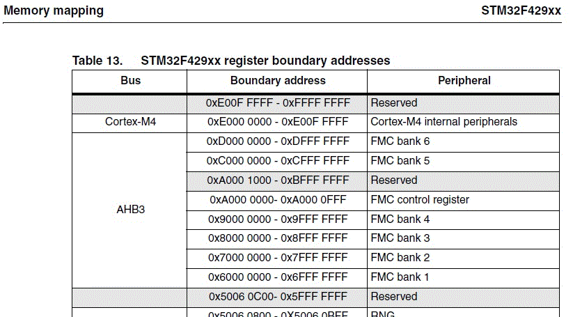

Posted on June 26, 2014 at 19:44
0xC0000000 is the SDRAM in the external memory space (STM324x9I-EVAL), the SDRAM is in a different bank on the STM32F429-DISCO at 0xD0000000
The external memory would need to be initialized before the C run-time start up code would be able to access it.

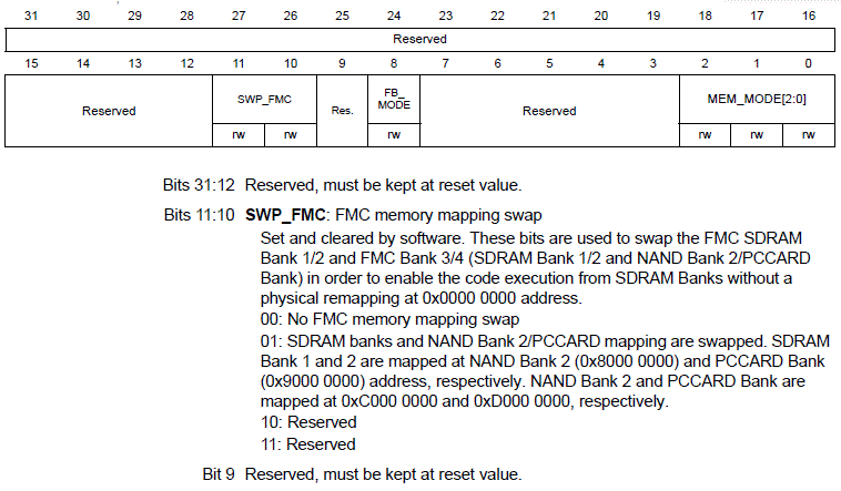

Aah this makes sense. I did copy some BSP code that initialized SDRAM on the evaluation board and can see it being called. Thanks a lot Clive1, appreciate the help. Can you point to any literature that tells me that the SDRAM address is set to 0xC0....
I was under the impression that acessing external SDRAM would have to use driver read write calls to access the addresses and that we couldn't just dereference an SDRAM memory address. IS that what the DMA2D is doing, SDRAM to LTDC buffer transfer ? In the LCDConf Driver supplied, offsets of these SDRAM addresses are fed directly to the LTDC driver via HAL_LTDC_SetAddress. It appears as though the SDRAM addresses can be directly accessed by the LTDC. Am I right about this? I was under the impression that the LTDC would only be able to read from SRAM.

Posted on June 27, 2014 at 01:41
The Data Sheet and Reference Manual, it's connected to FMC 5 or 6 depending on the board design
