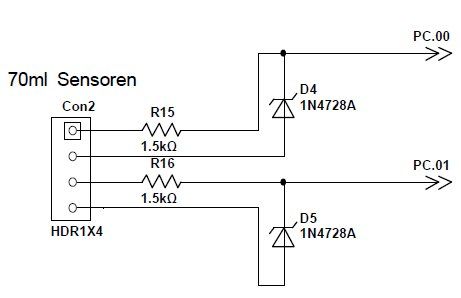

What are the pin states actually doing? Do you need pull up/down settings, or have them externally, diagram circuit.

Now I have the same code just with AFIO Clock enabled.
Both Interrupts are now working, but each Interrupt opens both IRQ Handlers. It's own first, and then the other one.
Do I have something wrong with my board? Resistance between PC.0 and PC.1 is >0,7MOhm - so this should be OK.
When I put a Voltage of 3V3 on PC.0 - PC.1 is under 0,05V and vice versa.
Design is as followed:
Two Sensors (24VDC) with each a resistor and a Z-Diode
EDIT:
The Programm is also going through the
if(EXTI_GetITStatus(EXTI_Line0) != RESET)
part - also in the wrong IRQ Handler - wich confuses me?!?
