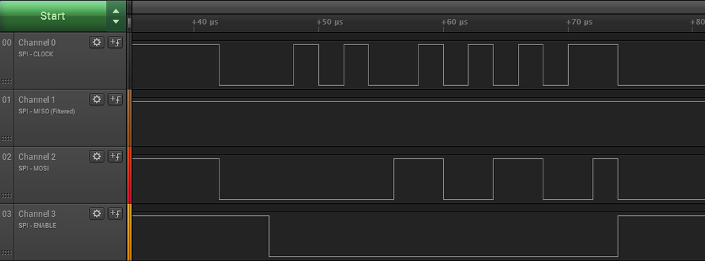

I have been trying to perform SPI communication and observe outgoing and incoming data through MOSI & MISO. There is a weird problem in SCK weveform
0690X000006C8kwQAC.pngThere are the codes I wrote :

What seems to be my problem ?

Too low sampling rate of the logic analyzer?
KOzdi
Oh ! Never came to my mind. I was puzzling my brain on it :) It works thanks a lot !
