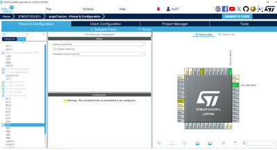

‎2024-12-04 11:28 PM
actually, i am new in working with ST.
I just install the CubeMX and Keil and create a very simple program to test Debug.
This is my project on CubeMX. as you see i just change the sys configuration to SerialWire.
in Keil, i
1- Change arm compiler to version 6 because version 5 was not installed in new version of Keil.
2- Set the optimization level to O0.
3- in the St-Link Debugger setting, the Connect and Reset setting are Under Reset and autodetect respectively (other options were also tried, but the problem still existed) . in flash download tab Reset and Run option is enabled. and in Pack tab, I unchecked the Enable option because when it was checked, The program could not be loaded on the micro, and the error of the genuinity of the micro was received (when it is unchecked, program could load on micro and work fine without debug mode of course).
