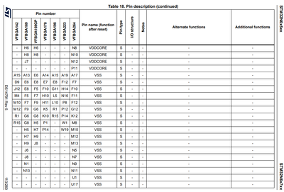

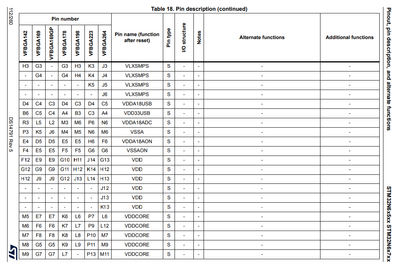

Hi @Yigitkilicli
If it is related to a custom design, check your pcb and gerber. I suggest to check if all VDD balls are correctly connected to VDD depending of the package you are using. Same for the unique VDDA18AON and all VSS.
Refer to DS14791 in the Table 18 to check which package balls for VDD are used:
In second time, can you get a oscilloscope capture of VDD and VDD18AON rising ?

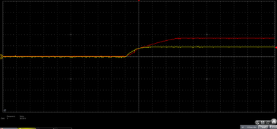

@RomainR.  Hello again,
 First of all, thank you for your help.
2) I checked two times. My pcb design, STM32N657X0H3Q footprint and schematic. But I can not found any fail. Because of I copy stm32n6 disco board schematic and I used 14mmx14mm same footprint uC.
2) The red line 3v3 VDDIO and the yellow line is VDD18AON. My scope 100us/div. In additionally, I used same regulator with stm32n6 disco board.LD39020ADTPU33R and LD39020ADTPU18R.
