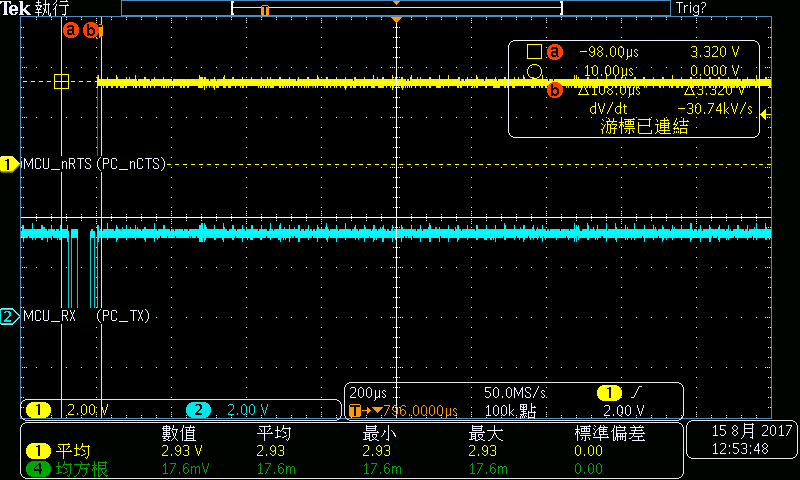

Issue : nRTS / nCTS behavior is NOT expectation,
description:
while(1){} empty loop is running on MCU, data is not taken from USART->RDR.
The expectation is nRTS is set to high until the data is read from USART->RDR
but the real case is the nRTS is asserted(tied low) after 500ms.
Is there any missing?

Yes, the nRTS is kept high about 500ms, then goes low even data is NOT read from USART->RDR.

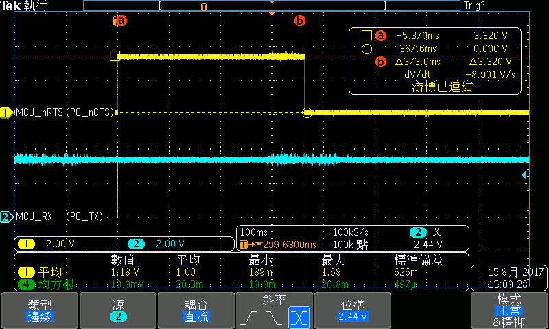

But the real case is that the nRTS goes low after 500ms even data is NOT read out from USART->RDR.

You haven't said very much about your development environment (e.g. if there is a debugger attached while you are doing your tests).
If you do have a debugger attached and the debugger is set to show you the state of the USART at a breakpoint then it is possible that the debugger is reading the USART periodically - even while the code is running. And anyone or anything reading the RDR will re-assert RTS.

Test1. View->System Viewer-> USART->USART 1 is NOT open in Keil debugger tool, USART1->RDR is not read in code.
Test 1 Result:
after sending a ASCII character on RealTerm application, the nRTS goes high which told PC it is NOT available to receive data because data is NOT read from USART1->RDR.
Test2. View->System Viewer-> USART->USART 1 is open in Keil debugger tool, USART1->RDR is not read in code.
Test 2 Result:
after sending a ASCII character on RealTerm application, the nRTS goes high then back to low because data is read from USART1->RDR by
