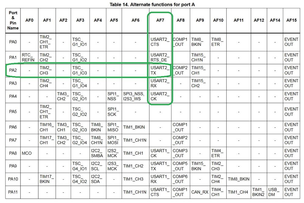

I'm trying to find instruction to code the usuart2 on this STM part. I using cmsis and the StdPeripheral lib. My end goal is to connect this to a virtual com port for debug. I'm using the Keil development environment.
I using the default HSI clock setup running at 8MHZ then -
RCC->AHBENR |= BIT17; //Enable portA clock
RCC->AHBENR |= BIT18; //Enable portB clockGPIO_InitStructure.GPIO_Mode = GPIO_Mode_AF;
GPIO_InitStructure.GPIO_PuPd = GPIO_PuPd_NOPULL; GPIO_InitStructure.GPIO_Pin = GPIO_Pin_2; GPIO_Init(GPIOA, &GPIO_InitStructure);RCC_APB1PeriphClockCmd(RCC_APB1Periph_USART2, ENABLE);
USART_InitTypeDef USART_InitStructure; USART_InitStructure.USART_BaudRate = 115200; USART_InitStructure.USART_WordLength = USART_WordLength_8b; USART_InitStructure.USART_StopBits = USART_StopBits_1; USART_InitStructure.USART_Parity = USART_Parity_No; USART_InitStructure.USART_HardwareFlowControl = USART_HardwareFlowControl_None; USART_InitStructure.USART_Mode = USART_Mode_Rx | USART_Mode_Tx; USART_Init(USART2, &USART_InitStructure);//send the data
USART_SendData(USART2, 0xaa);
I realize the baud may be wrong but right now I'm trying to see something on the PA2 pin
with a scope. Nothing is changing.

PA2 according the manuals is connected to UART2TX.
Is this all I need to make sure the GPIO pin is connected to the UART2TX?
Randy
2018-02-16 3:16 PM
Also needs mapping through the mux
/* Connect PA2 to USART2_Tx */
GPIO_PinAFConfig(GPIOA, GPIO_PinSource2, GPIO_AF_7); // USART2 MUX AF72018-02-16 3:27 PM
It now works.
I have often wondered how the 'AF' devices connect to the pins. Can you point to a document that clearly explains this? The RM0316 on the STM32F303 MCU does not cover it much.
Thanks Clive,
Randy
2018-02-16 3:34 PM
Data Sheet, Table 14
