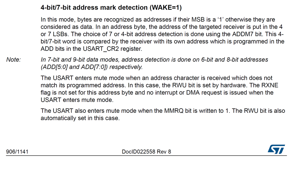

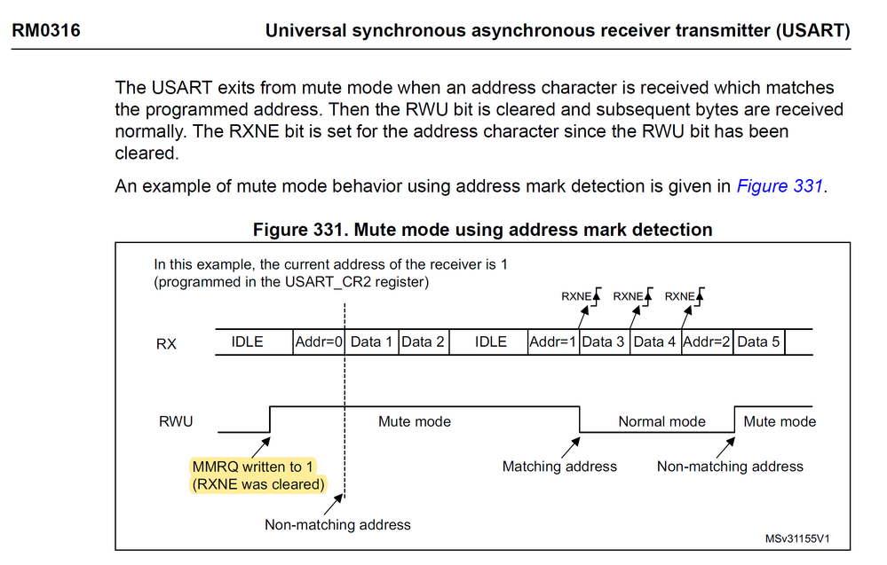

Multiprocessor mode with address mark detection only receives data which has '0' as MSB. After waking up (RWU=0) when the correct address is received subsequent bytes should be received normally, and not interpreted as another address?
RWedu.1

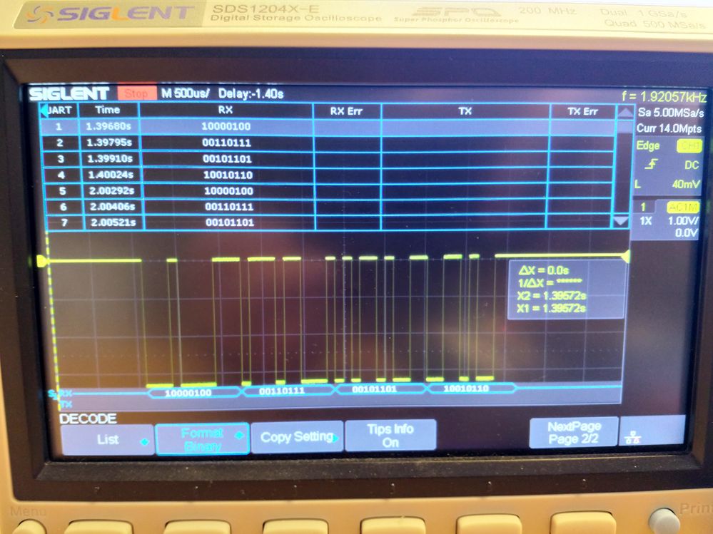

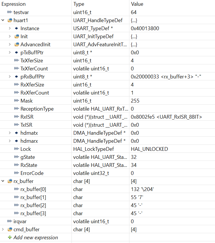

I have configured the UART for multiprocessor communication over RS485. I can receive and transmit data correctly, but if the data contains a '1' as MSB it is interpreted as an address. Now it is clear from the documentation that this is the correct behavior, but after the correct address is received (RWU set to 0 and RXNE set to 1, confirmed by debugging) I can only receive data < the defined address. For example, if I set wordlength to 9bit and the address to 4, the correct address will be 132 (10000100) which is expected. But subsequent bytes are still interpreted as addresses. Sending 132,55,45,150 (via RealTerm) will only receive 132,55,45 as 132 is the correct address and 44,55 has '0' as MSB. 150 is interpreted as a new address and RWU is again set to 1 since it is incorrect and I can no longer receive data.
My question is how can i interpret subsequent bytes after an correct address as pure data bytes, before I go back to listening for an address again? If I understand correctly, RWU and RXNE is set by HW in this mode? Or is there something specific I should do in FW? My implementation is interrupt-based for now.
