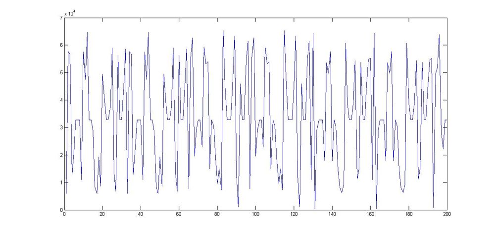

Hallo,
I am working on extracting the data from the
MP45DT I used PDM filter function. I gave a beep sound to the microphone in the certain frequency, but I noticed that the captured raw data is not given as a sine wave.0690X00000603KDQAY.jpg
Is this kind of data is correct ? because I am expecting some sine wave.The sound frequency that is transmitted to the MIC is 1000Hz. This is my setting for the MP45DT

Posted on June 09, 2015 at 19:24
Is the data really UNSIGNED 16-bit? If not think about how two-complement data might plot on a 0-70000 scale...
f23
Posted on June 09, 2015 at 20:49
Thanks for the reply clive1,
Yes the output data after go through the filter is Unsigned 16. I collected each 32 samples after interrupt of the DMA double buffer and put it in one array and plotted it.
 But as you see from the graph, the wave form is quite weird. I dont know if my settings  are wrong or not . Supposedly we should expect some kind of sine wave right, if we emit sound in certain frequency to the microphone?

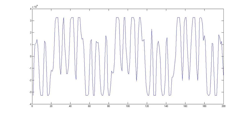

Posted on June 09, 2015 at 21:22
Yes, and to which I suggested that you consider if this is actually UNSIGNED data. I doubt that it is, plot it as SIGNED data in the +32767 to -32768 range.
f23
Posted on June 10, 2015 at 02:06
Thanks Clive1
I do the casting for converting the unsigned 16-Bit to signed 16-Bit. Is it correct?

And this the best possible plotting I got. 0690X00000603KIQAY.jpg Is there anything else I miss?
