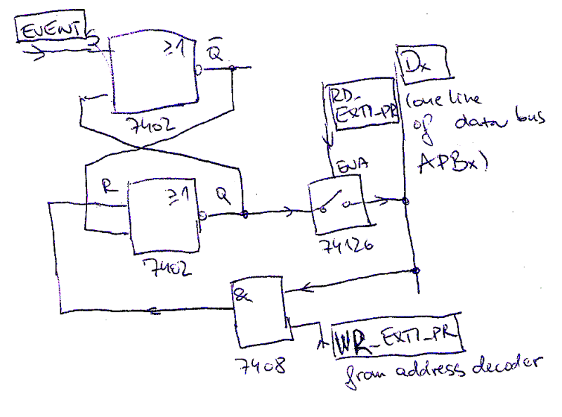

    Hardware sets the EXTI_PR bits so that you can read 1 out from them.
    By software, the bits you write 1 into them get cleared, so you can read 0 out of them.
    Think of 20 R-S flip-flops; with the S line of each flip-flop tied to the internal hardware detecting the edge; the R line tied to outputs 0..19 of a multibit gate which opens from the common bus when the address decoder detects write to the register's address; and the outputs of latches connected to inputs of the gate opening to the common bus when the address decoder detects read from the register's address.

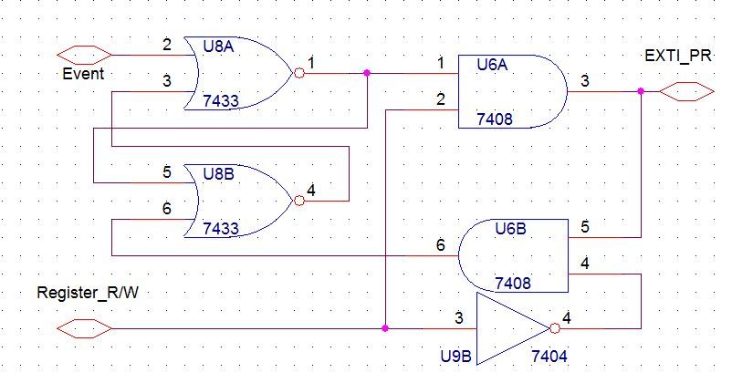

    Posted on April 18, 2018 at 09:30
    Yes, with a few minor corrections:
