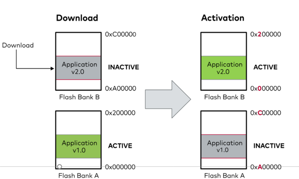

hello,
my project was to do a over the air update, looking for various strategies and I found one in the vector website.
https://www.vector.com/int/en/products/application-areas/embedded-software/embedded-trends/ota-update-approaches/#c230972
This method is called hardware supported a/b swap.
I have stm32f411re and is it possible to do a memory swap like the below image in mcu??
