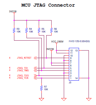

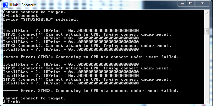

What exactly does the entire connection log from J-Link commander look like? Does it expect you to connect VCC along with GND. The circuits would always need a common ground, the IO buffers may also require a target supply. You'd want to use standard JTAG/SWD headers in designs, it makes connectivity easier and consistent.

 Here's the log from the JLink after trying to connect with the board with boot0 High:
When boot0 is low, the log says it cannot connect under reset and TDO is constant high. TDO would be high because the target device is pulling it up with 3.3 volts. Here's the schematic of the JTAG connector of the target device.
I've connected 3.3v (pin 6) to the VTRef of the J-Link. The board and J-Link have common grounds. All the pins needed for JTAG/SWD are connected respectively including the Reset button (that is not in the shown schematic but pulled out through a wire).
Before having problems with the connection, I was testing out the buttons if they are functioning properly. Then when I tried uploading the program to the device again, it suddenly gave me this ''Cannot connect under reset'' error. I did declare some unused GPIO to inputs or outputs but have not touched them yet as I was changing my program a little bit at a time. Is it possible that I have changed some GPIO that was not supposed to be changed that is why I could not connect to it anymore? I checked the reference manual of the STM32F103RD and I didn't change any of the GPIO that are connected to the JTAG/SWD connectors that might have caused the problem. I only changed the following:
