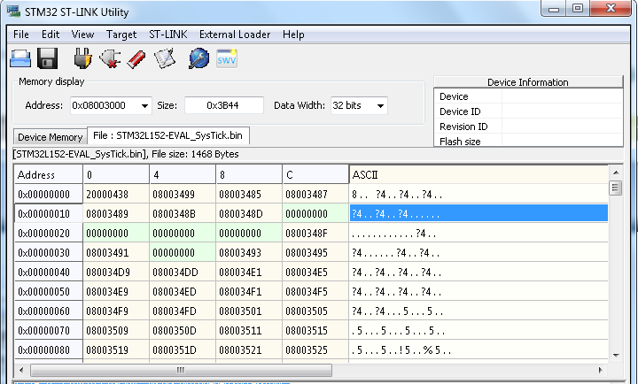

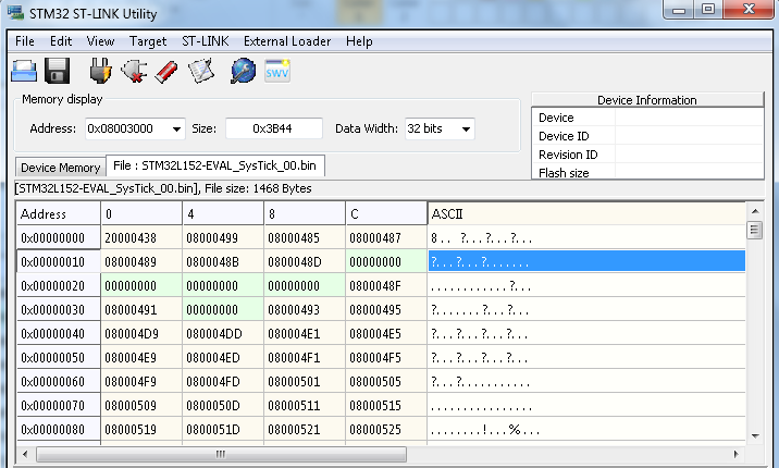

What I notice that content of the binary files with address 0x08003000 and 0x08000000 are different. Will that be the reason why it did not work?
Below are the binary files opened with STM32 ST-LINK Utility. They are compiled with IAR Workbench. You can see there are many difference even they both let the LED toggled the same way.

SysTick_00 is not built for 0x08003000 operation, note the addresses in the vector table.
It is critical that the linker build the image for 0x08003000 (or whatever the basis needs to be). Your second example appears to meet that criterion.
Can you be more specific about the .H files with absolute addresses? It is the linker, via linker scripts, or scatter files, that determines where the code gets situated.
