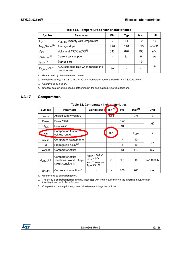

On a low power application, using STM32L031x, I want to monitor a 3-level signal (24V, 5V, 0V) using COMP1 and COMP2.
  • COMP1IN+ and COMP2IN+ connected to a voltage divider with two resistors (2M-220K)
  • COMP1IN- connected to internal VREF, so COMP1 capture 24V-5V transition (rising and falling edges)
  • COMP2IN- connected to internal VREF/4, so COMP2 capture 5V-0V transition (rising and falling edges)
Comparator positive input are configured by software on analog input mode, No pull-up, pull-down
When the 3-level signal under test goes to 0V, I measure about 400mV instead of 0V on COMPxIN+ (so COMP2 never toggle): is there a leakage current (it's about 400mV/200K=2uA) from comparator inputs that alter the external voltage divider? Maybe from internal pullup?
Or there is a mistake/inaccuracy on comparator and/or GPIO software configuration?
Thanks for your support!
Massimo

I have no experience with the comparators in 'L0, but maybe this is the reason for the behaviour you observe:

What I want to say is that COMP1 may inject the current you see if you try to pull it below 0.6V; and as you have both comparators' pins connected, that prevents the other comparator to see the lower transition.
Maybe try using two individual dividers.
