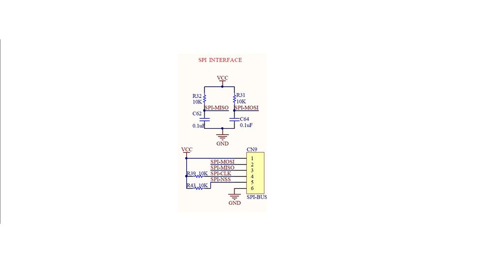

Posted on July 27, 2017 at 13:16
I am using
Cubemx,
IDE:Keil 5
MCU:STM32F405 (using inbuilt SPI-1 engine).
Flash Memory:Atmel AT45DB041
MCU PIN's:
/**SPI1 GPIO Configuration
PA4 ------> SPI1_NSS
PA5 ------> SPI1_SCK
PB4 ------> SPI1_MISO
PB5 ------> SPI1_MOSI

Please refer above attached schematic.
Thank you.

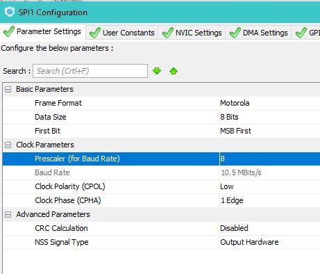

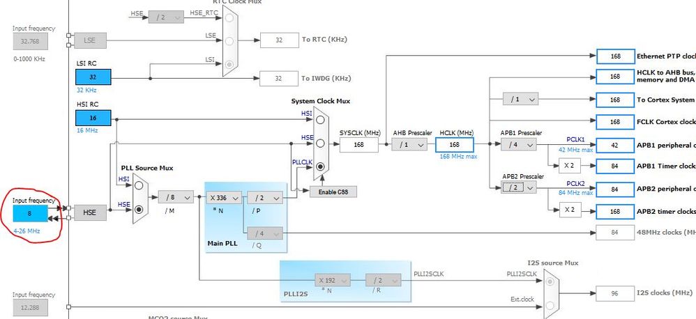

Hi Again!.
Sandeep i dont understand how this initialisation code produced.
RCC_OscInitStruct.PLL.PLLM = 2;
RCC_OscInitStruct.PLL.PLLN = 3; // can 't be 3
does not have any sense .
Begin from Basics .

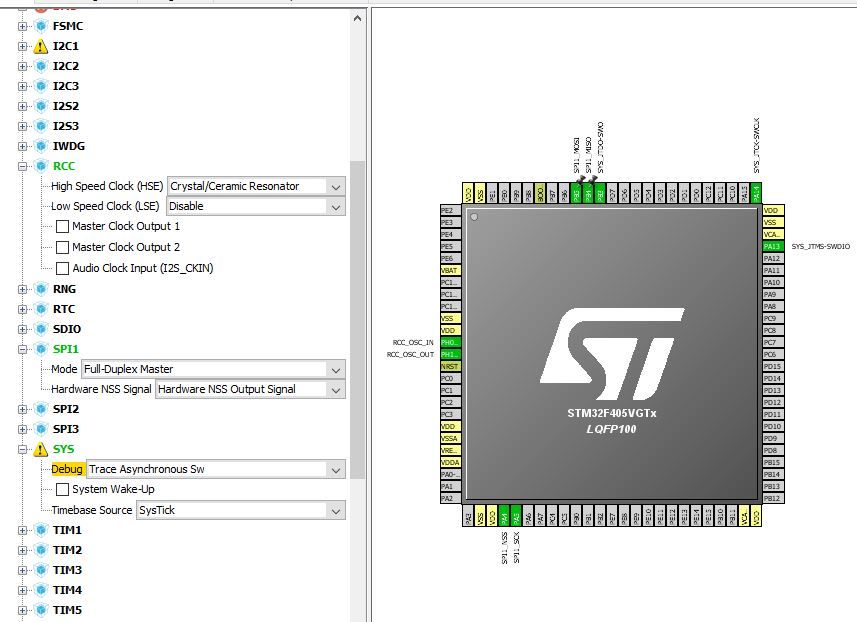

Make a project at STM32CubeMX with your device (exact type)
put the value of your crystal in MHZ in the blue box and set clocks (eg like this)
And initialize your spi port
Make some other settings to produce code for KEIL
and generate the source projet
fully initialized
with theese setings
then at your main function you can use
Majerle.Tilen
sugestion to transmit a byte!
you must expect ~10MHZ pulse series from clock pin to measure with DSO
