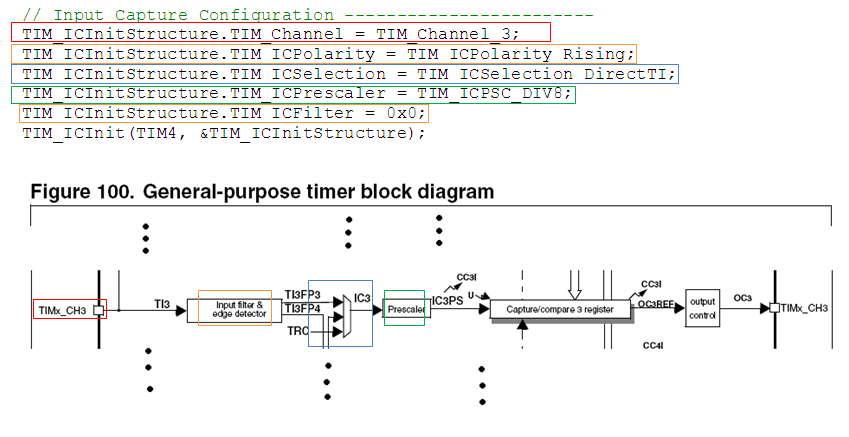

Look at Figure 100, All Densities Reference Manual RM008, Rev 10 to see the relationship between channels and capture compare registers.

I see exactly what you are talking about in Figure 100. This basically means that there is a 'daisy chain' of configuration that has to be made in order to capture the transitions on TIM4_CH4. It is the following:
(1) TIM4_CH3 (2) TI3 (3) Input Filter/Edge Detector (4) IC3 (5) Prescalar (6) IC3PS (7) Capture/Compare 4 Register The configuration for making IC3 = TI3 is set by ''TIM_ICInitStructure.TIM_ICSelection = TIM_ICSelection_DirectTI;''. For some reason when I configure TIM4_CH3 (TI3) to be selected as IC3 I cannot get my firmware to generate an interrupt and call ''TIM4_IRQHandler()''. I am using Keil RL-RTX and the library provided by Keil in ''C:\Keil\ARM\RV31\LIB\ST\STM32F10x'', where the NVIC is configured for TIM4_IRQChannel (=0x1F in Keil Library). Is there anyway to troubleshoot why timer 4 is not generating an interrupt that calls the TIM4_IRQHandler() function? The code modification that I have made is the following:void InitializeInputCapture(void) { TIM_ICInitTypeDef TIM_ICInitStructure; GPIO_InitTypeDef GPIO_InitStructure; NVIC_InitTypeDef NVIC_InitStructure; // RCC Configuration ------------------------------------------------------- // TIM3 clock enable RCC_APB1PeriphClockCmd(RCC_APB1Periph_TIM4, ENABLE); // GPIOA and GPIOB clock enable RCC_APB2PeriphClockCmd(RCC_APB2Periph_GPIOB, ENABLE); // Configure the Nested Interrupt Vector ----------------------------------- // Enable the TIM3 global Interrupt NVIC_InitStructure.NVIC_IRQChannel = TIM4_IRQChannel; NVIC_InitStructure.NVIC_IRQChannelPreemptionPriority = 0; NVIC_InitStructure.NVIC_IRQChannelSubPriority = 1; NVIC_InitStructure.NVIC_IRQChannelCmd = ENABLE; NVIC_Init(&NVIC_InitStructure); // Input Capture Pin Configuration ----------------------------------------- GPIO_InitStructure.GPIO_Pin = GPIO_Pin_8; //GPIO_InitStructure.GPIO_Mode = GPIO_Mode_IN_FLOATING; GPIO_InitStructure.GPIO_Mode = GPIO_Mode_IPU; GPIO_InitStructure.GPIO_Speed = GPIO_Speed_50MHz; GPIO_Init(GPIOB, &GPIO_InitStructure); // Input Capture Configuration --------------------------------------------- TIM_ICInitStructure.TIM_Channel = TIM_Channel_3; TIM_ICInitStructure.TIM_ICPolarity = TIM_ICPolarity_Rising; TIM_ICInitStructure.TIM_ICSelection = TIM_ICSelection_DirectTI; TIM_ICInitStructure.TIM_ICPrescaler = TIM_ICPSC_DIV8; TIM_ICInitStructure.TIM_ICFilter = 0x0; TIM_ICInit(TIM4, &TIM_ICInitStructure); // TIM enable counter TIM_Cmd(TIM4, ENABLE); // Enable the CC2 Interrupt Request TIM_ITConfig(TIM4, TIM_IT_CC3, ENABLE); }- Mark as New

The corresponding configuration is the following:
