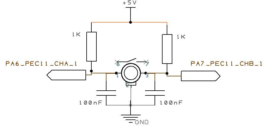

I have a big mystery, based on incremental rotary encoders. I use a PEC11encoder
http://www.adafruit.com/datasheets/pecpdf
to control my STM32F4. I have no problem with it, it's working more than perflectly. But when I replace it with a PEC16encoder
https://www.bourns.com/pdfs/pecpdf
(supposed to be exactly the sameelectrically) my code isn't working anymore. I can only get one rotation direction. This is my circuit: 0690X00000602z1QAA.jpg PA7 works with an interrupt:

To resume, when the CHANNEL B of the encoder change of state, the interrupt is activated and the code check the CHANNEL A and channel B state to detect the rotation. It perfect with PEC11 and not works with PEC Do you have any ideas why? Thanks a lot for your help. Jean

I have a big mystery, based on incremental rotary encoders. ... (supposed to be exactly the same electrically) my code isn't working anymore. I can only get one rotation direction.
And when  you eyeball the signals with a scope do they actually behave the same?
jean_prieur
Posted on December 08, 2014 at 18:22
Yes they looks the same but it's hard to know, because it's depends of the rotation speed...
ivani
Posted on December 08, 2014 at 20:18
The order of contacts of PEC11 is A-C-B. For PEC16 it is A-B-C.
Did you change the wiring when you changed the encoder?
jean_prieur
Posted on December 09, 2014 at 11:28
Thanks Ivan !
I missed it... This is so small in the datasheet and not logical from Bourns...
But now it works !
