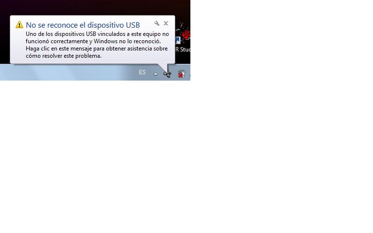

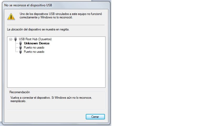

But, my main problem is that board does not work with St link utility. i pluged, it starts blinking, but st-link utility does not recognize. is like stlink, on board does not have Bootloader or firmware that manage the usb protocol, is it possible. let me put a picture. sorry about but my native language is spanish, and how you see, my operating system too.

Hello, maybe reinstal the st-link driver, you can fine in the ST weeb page.
ing23
Posted on October 21, 2011 at 03:50
actually, i did it.
you know what???
i change my usb cable, and guess what?? windows recognize stm32vl as massive storage.
